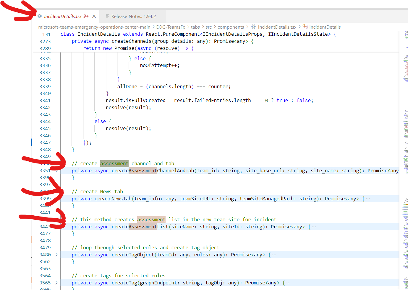

  3. Also, the current solution will create Assessment channel when a new incident item gets created. But in our case we need to create 5 additional channels and remove the Assessment channel. So, I will add the new methods to create the additional channels inside the following IncidentDetais.tsx file:-
TMFQy6wJ
everything is somehow easy to me from the coding part. But I am not sure how I can keep my Fork repository in sync with future updates from the upstream? let say in a future release done by the upstream they also modify the IncidentDetais.tsx by adding more channels, then how we can get those updates and at the same time keeps our modifications? Is there a way to do this? or we will need to manually merge our changes to the updated IncidentDetais.tsx file ?
