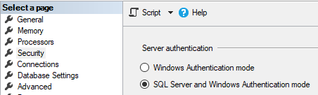

    Did you enable SQL authentication - or just try to enable the 'sa' account? If the latter - that won't work because you need SQL authentication enabled, and by default when you install SQL Server it installs as windows authentication only.

    Please using Windows authentication in SSMS to login and go to server name and right-click to select properties ->select security tab, ensure you have enabled the SQL Server and Windows Authentication mode. If not, you need to enable it and restart the SQL Server service.
