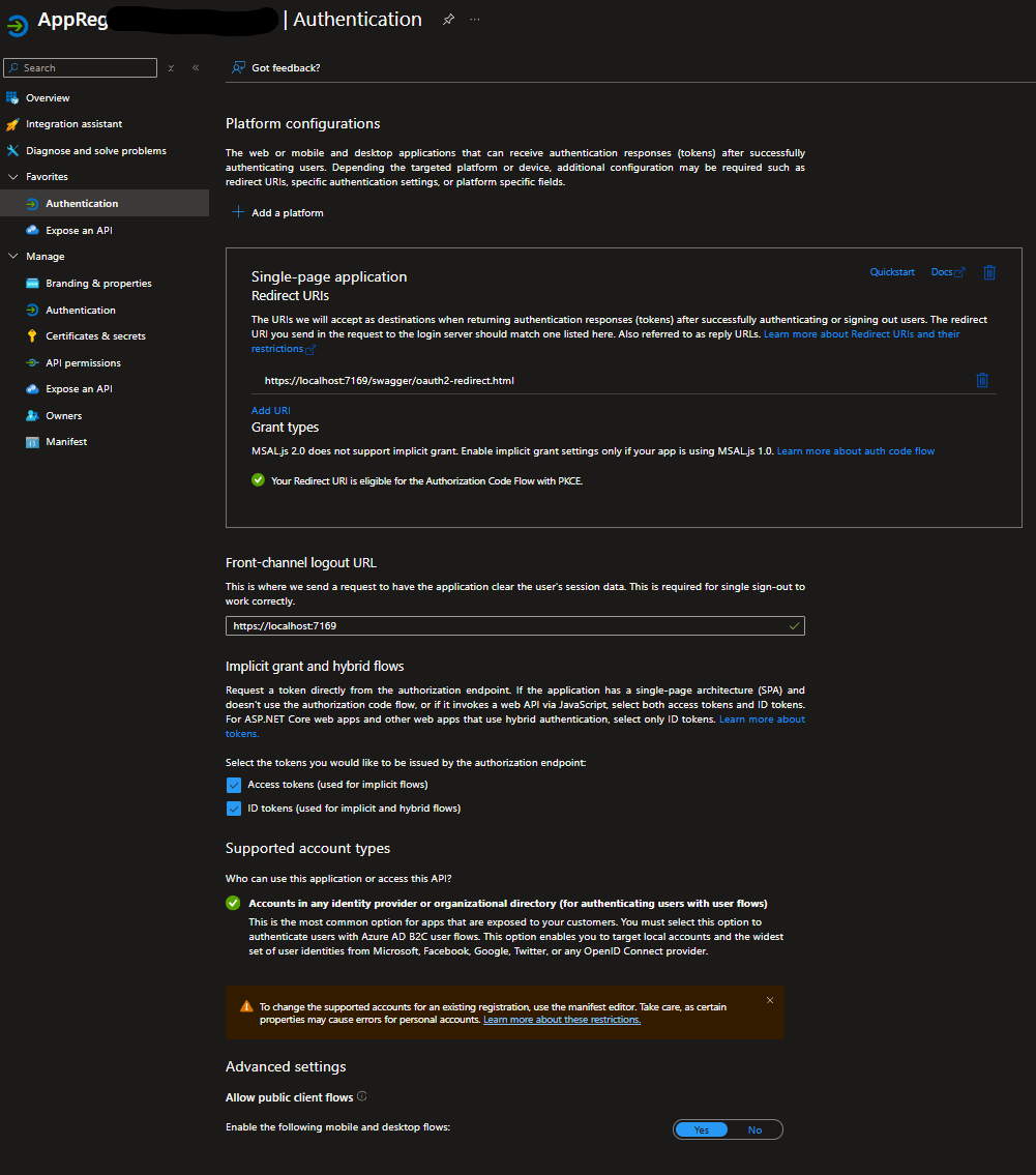

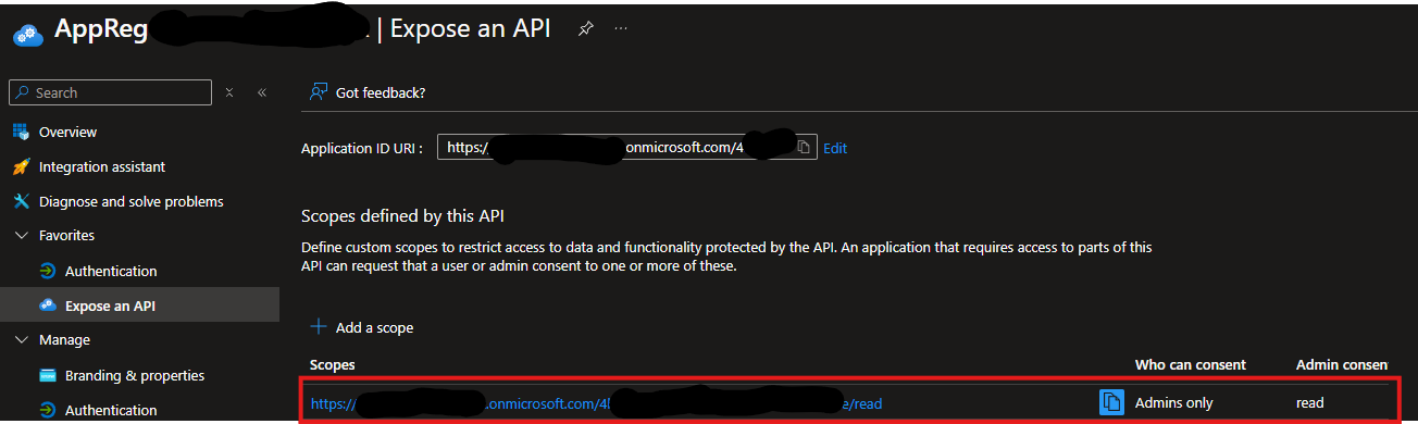

since weeks (with on and off phases) I try to protect my ASP.Net project with the Azure B2C. For testing if that works I want to use Swagger. But I am too stupid to make it a success. I got all kinds of error messages but I am unable to get a valid token to test the authorization. I require code help because I am blind for my mistakes. My frustration level is already high. But let me show you my status:
My project structure
But I only use the Program.cs and the appsettings.json currently.

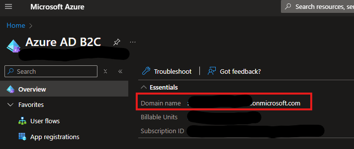

Used for TENANT_NAME

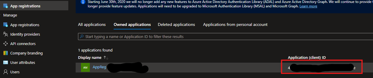

Used for CLIENT_ID:

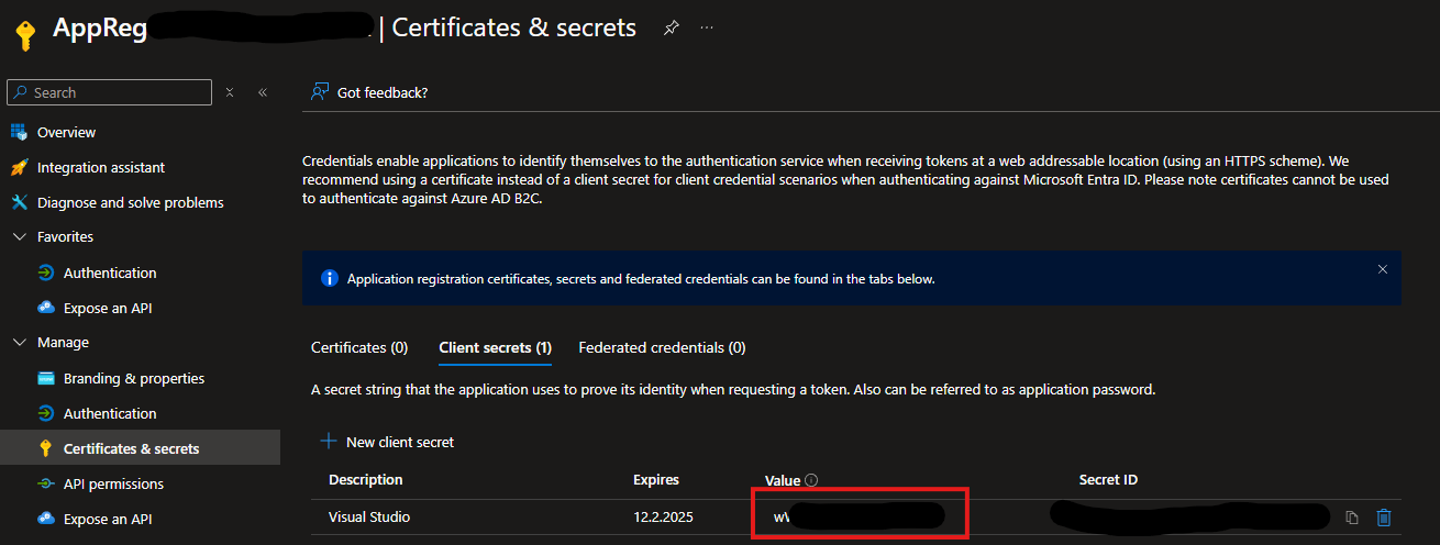

Used as CLIENT_SECRET:

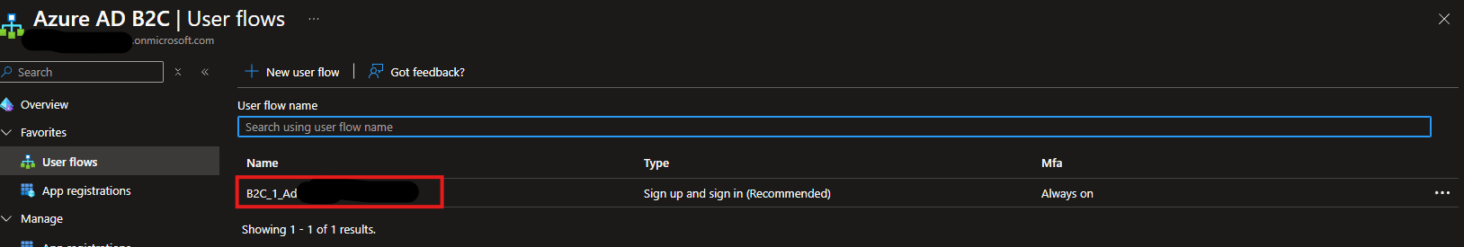

Used for B2C_1_AdAZURE_B2C_TENANT_NAME:

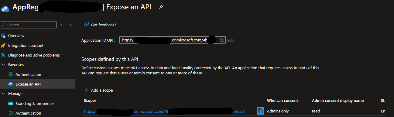

The SCOPE I tried before:
But this caused: "Response status code does not indicate success: 400 (Bad Request)". So I switched it to "https://TENANT_NAME.onmicrosoft.com/CLIENT_ID/.default".
Settings of AUTHENTICATION:
My appsettings.json:

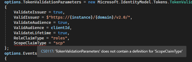

        options.TokenValidationParameters = new Microsoft.IdentityModel.Tokens.TokenValidationParameters
            ValidateIssuer = true,
            ValidIssuer = $"https://{instance}/{domain}/v2.0/",
            ValidateAudience = true,
            ValidAudience = clientId,
            ValidateLifetime = true

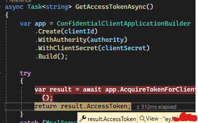

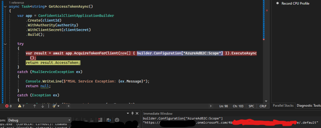

async Task<string> GetAccessTokenAsync()
    var app = ConfidentialClientApplicationBuilder
        .Create(clientId)
        .WithAuthority(authority)
        .WithClientSecret(clientSecret)
        .Build();
    try
        var result = await app.AcquireTokenForClient(new[] { builder.Configuration["AzureAdB2C:Scope"] }).ExecuteAsync();
        return result.AccessToken;
    catch (MsalServiceException ex)
        Console.WriteLine($"MSAL Service Exception: {ex.Message}");
        return null;
    catch (Exception ex)
        Console.WriteLine($"Unexpected error: {ex.Message}");
        return null;
if (app.Environment.IsDevelopment())

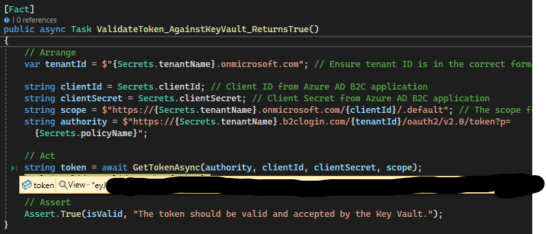

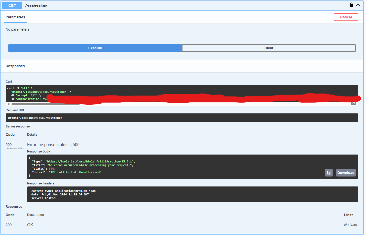

FAILS/RESULTS:
1.) Try
Create a Test Method to get a token
Copy the token

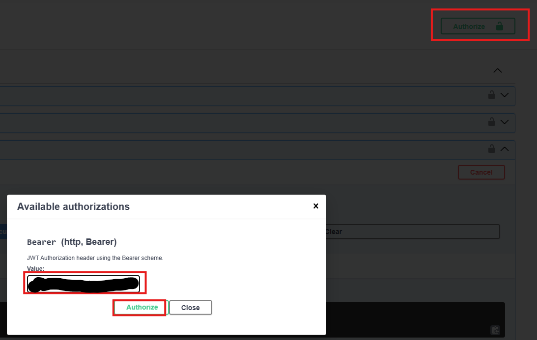

Authenticate in Swagger
The dialog closes. Testing "/test":
Server response
Code	Details
401
Undocumented
Error: response status is 401
Response headers
 content-length: 0
 date: Sat,19 Oct 2024 09:30:09 GMT
 server: Kestrel
 www-authenticate: Bearer error="invalid_token"
  1. Try
User's imageUser's image
  "type": "https://tools.ietf.org/html/rfc9110#section-15.6.1",
  "title": "An error occurred while processing your request.",
  "status": 500,
  "detail": "API call failed: Unauthorized"
Any ideas?
My code is a mess and I don't need to keep it. All I want to achive is to make a authorized GET request as a test to verify that my Api endpoint is secured by the Bearer token.
