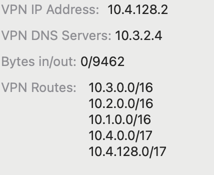

  • I can confirm that the VPN is using the specified private DNS. It shows up in the Azure VPN UI once connected and I can no longer browse the internet since my machine's normal DNS is no longer being queried. Screenshot 2024-10-21 at 21.11.36
