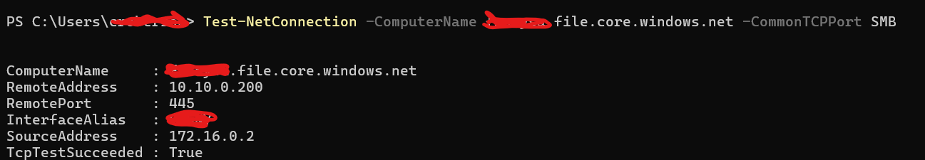

I have configured Azure File Shares that are available publicly currently. I have P2S VPN access for home users where port 445 is blocked, however I'm having issues with them being able to connect to the shares. I quickly figured out the issue was DNS related, as the fqdn was still resolving publicly as opposed to over the VPN. I fired up a DNS Private Resolver and updated the VPN config with the inbound endpoint IP. Initially that worked like a charm, and I assumed all was good. For some reason, it just stopped working. Running a Test-NetConnection only is successful in resolving the internal private endpoint IP (screenshot), with the VPN connected, and configured with the private resolver. Not sure what I'm missing?Screenshot 2024-10-21 152636

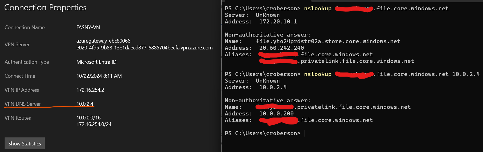

    Thank you @Manu Philip and @Vinod Kumar Reddy Chilupuri . Let me just explain a little more. I have the P2S VPN already configured using Azure Active Directory, and file shares configured using Microsoft Entra Kerberos. The setup you see in the screenshot is a laptop connected to my cell phone's hotspot (445 is blocked), simulating an off-prem (home, hotel, etc) environment. As you can see, the Azure VPN is connected, and I have the IP of my DNS Private Resolver configured (10.0.2.4). Doing an nslookup to the share FQDN still references the WiFi connections DNS, resolving the external IP of the share. Doing an nslookup and specifying the DNS Private Resolver resolves the private link of the storage accounts FQDN properly (10.0.0.200). This is where I'm hung up...how to successfully resolve the private link of the storage account while off-prem.Screenshot 2024-10-22 081353
