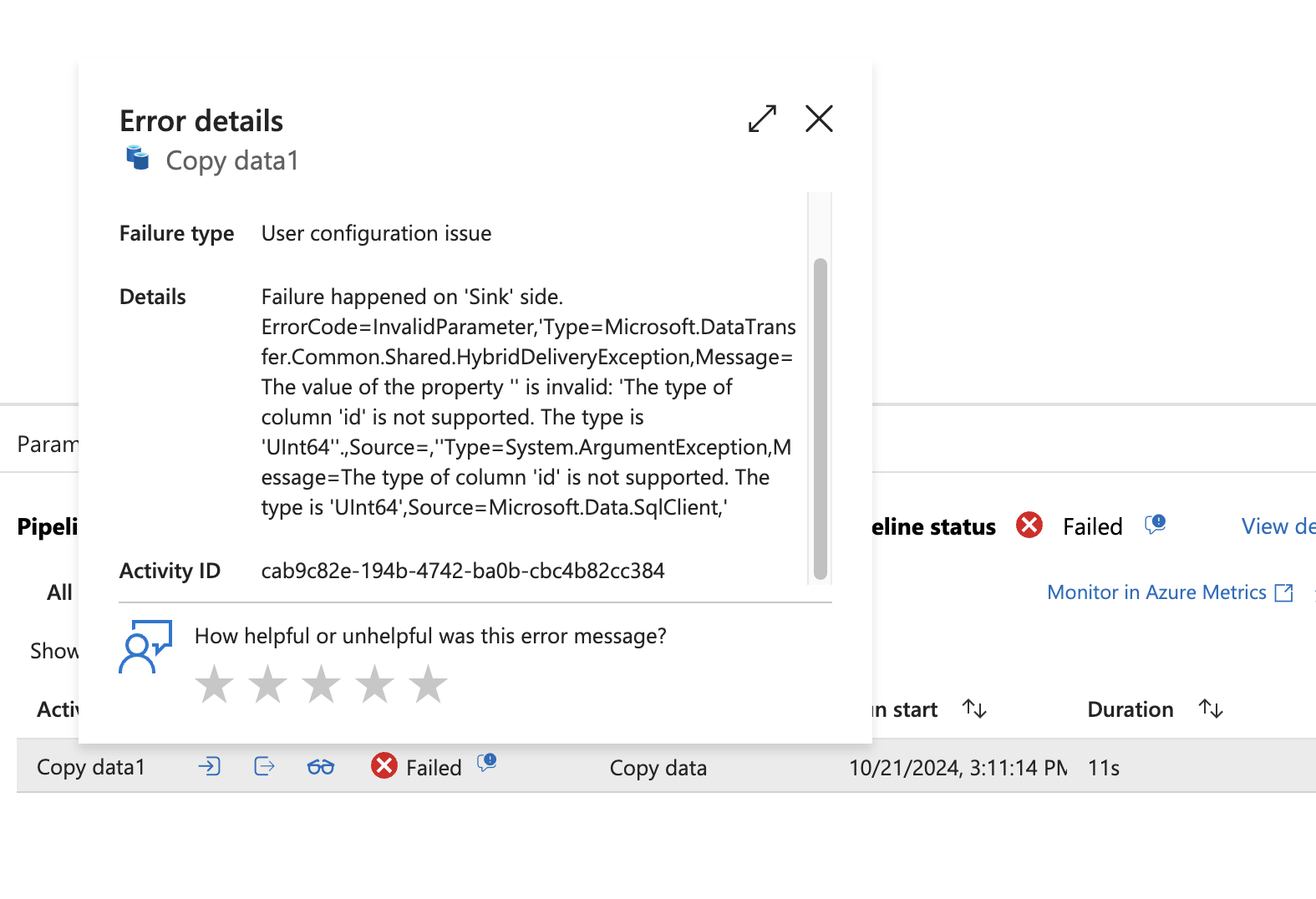

I am having the following problem when I try to sink data from on premise MySQL database to Azure SQL database:
Failure happened on 'Sink' side. ErrorCode=InvalidParameter,'Type=Microsoft.DataTransfer.Common.Shared.HybridDeliveryException,Message=The value of the property '' is invalid: 'The type of column 'id' is not supported. The type is 'UInt64''.,Source=,''Type=System.ArgumentException,Message=The type of column 'id' is not supported. The type is 'UInt64',Source=Microsoft.Data.SqlClient,'

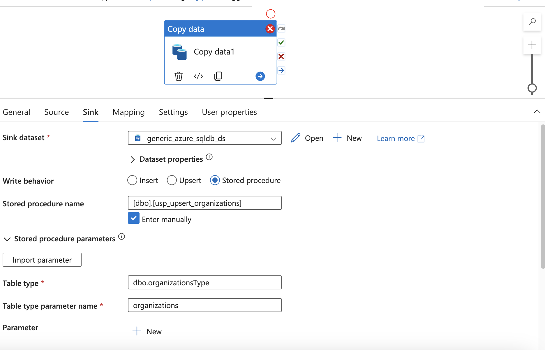

I defined a Table type in the Sink side Screenshot 2024-10-21 at 23.45.24
The source Dataset previews the data fine, but when copy activity runs i get the above error:
Screenshot 2024-10-21 at 15.11.42I tried changing the json mapping to sync data types between source and SQL sink but still getting the same error. My source dataset uses a query, i.e. select * from [mysql_schema].[table]. If i change the query to a simple cast on the specified column, i,e. select cast(id as nchar), [col2],... from [mysql_schema].[table] it works fine, but i need to be able to issue a select * from.. statement to parameterize my pipeline. How should i proceed?

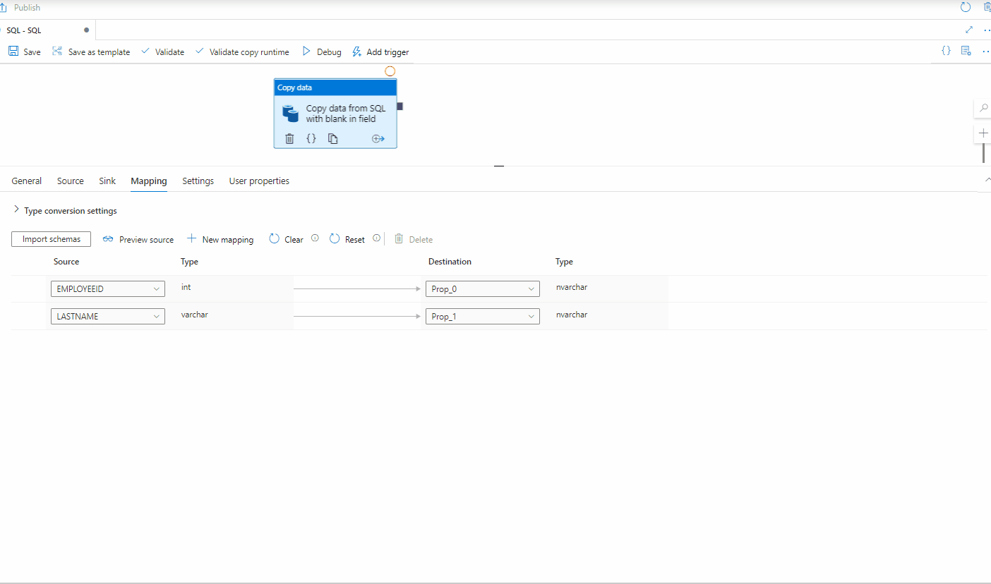

      Use a Mapping in Azure Data Factory: If you want to keep using SELECT *, you can define a mapping in the Copy Activity settings. In the mapping section, explicitly map the id column to a compatible type in Azure SQL (like BIGINT).
    2. Edit the JSON Payload: If you’re comfortable with JSON, you can directly edit the JSON payload of the Copy Activity to specify the data type for the id column. This can be done in the Azure Data Factory UI by switching to the code view.161233-datatypeupdatecopymapping.gif
