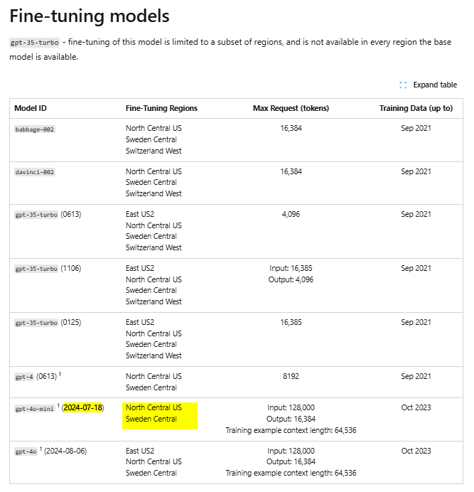

    Aditya Apologies for the delay in response.I further verified from my end and found that the gpt-4o-mini 2024-07-18 model is not available in East US region for fine-tuning.Only available in below mentioned regions. see region where gpt-4o-mini-2024-07-18 fine-tuning is available?
    I would suggest you, please try in any of the available regions and let me know if that solves your issue.
