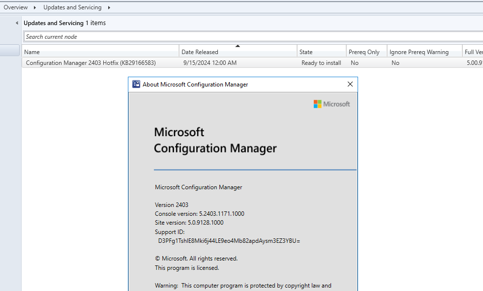

-----Before installing this hotfix, should we first repair any configurations that use the Management Point Computer Account, or can we repair them quietly after installing this hotfix KB29166583? In detail what configurations would need to be changed?
Note : In the Console we see only one instance of the hotfix KB29166583(Date Released 09/15/2024). Also, the link in the description does not direct to anything 'https://aka.ms/KB29166583'.

  1. Simon Ren-MSFT 40,386 Reputation points Microsoft External Staff
    2024-10-28T05:56:30.4466667+00:00
    Thank you for posting in Microsoft Q&A forum.
    1,We don't need to install the hotfixes one by one, just installing the latest one is OK.
    2,==>In the Console we see only one instance of the hotfix KB29166583(Date Released 09/15/2024).
    This is normal. In my environment, it's the same as yours.
    2403png
