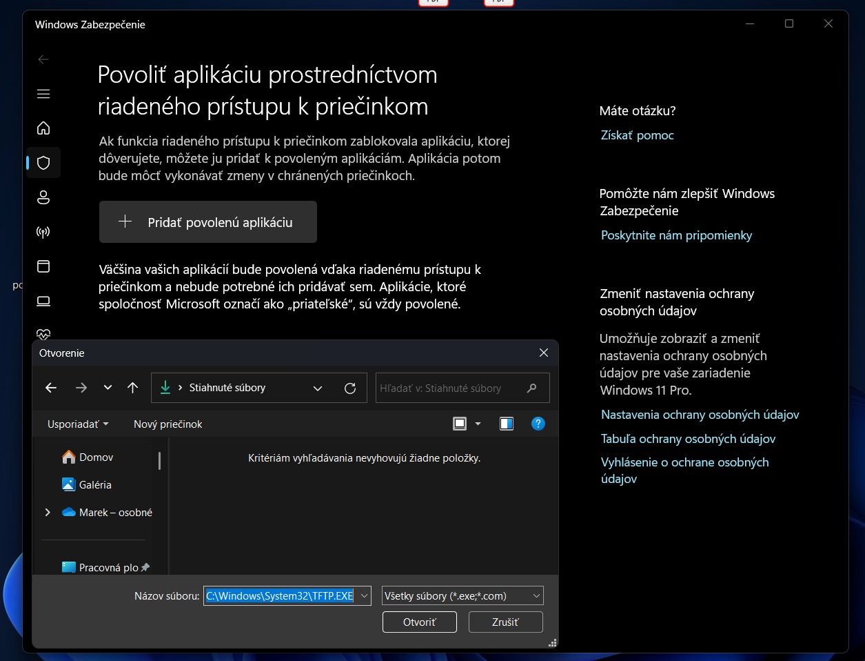

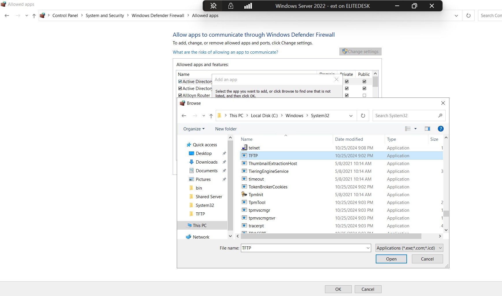

  3. Marek Miklovič 5 Reputation points
    2024-10-30T18:33:25.04+00:00
    Hello Daisy Zhou, thank you for your answer!
    Unfortunately:
    1. I do not have any blocking rules in the inbound and outbound sections.
    2. The TFTP Client is installed as you described.
    3. I have tried the test with turning off the Microsoft antivirus, but it didn’t help. Only turning off the whole firewall allows the communication, which means the issue is probably within the firewall.
    4. I want to use PowerShell.
    Luckily:
    By coincidence, I have found the solution for this issue while writing this comment.
    Solution:
    1.
    Missing allowance for the application "TFTP.EXE" in this section: Control Panel\System and Security\Windows Defender Firewall\Allowed apps
    TFTP.EXE path: "C:\Windows\System32\TFTP.EXE"
    Added through "Allow another app..."
    2.
    Allowance for the "C:\Windows\System32\TFTP.EXE" in the antivirus section.
    This issue was not only about firewall rules and UDP 69, because this port (69) is used only for initialization of communication. Afterwards, another port is dynamically chosen from a wide range, which is not possible to securely allow through inbound/outbound rules. Allowing the app through is the answer then. I am new to these topics and issues with Windows, which is why I did not know that TFTP.EXE exists and corresponds with the MS native TFTP client feature.
    Have a nice day.
    Marek
