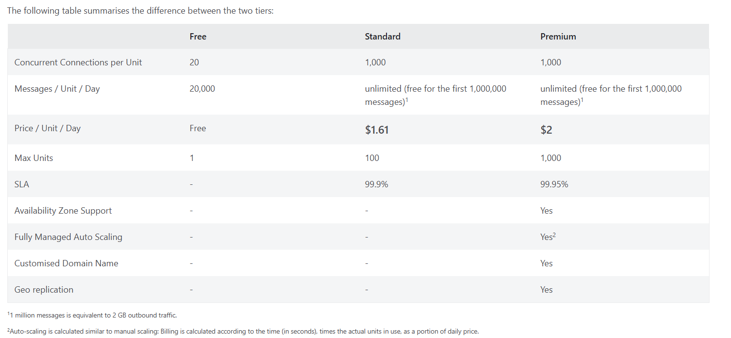

    1.What about be monthly charges for running this sample?
    Web PubSub service is currently available in Free, Standard, and Premium tiers. These tiers are differentiated by the number of concurrent connections, messages and maximum units allowed.
    (screenshot below which summarizes the difference between tiers)
    2.With your requirement/resources - Leverage Azure pricing calculator to get an estimate of the cost : https://azure.microsoft.com/pricing/calculator/?service=web-pubsu
    3.You cannot pause the resource, but can stop the Azure resource.
