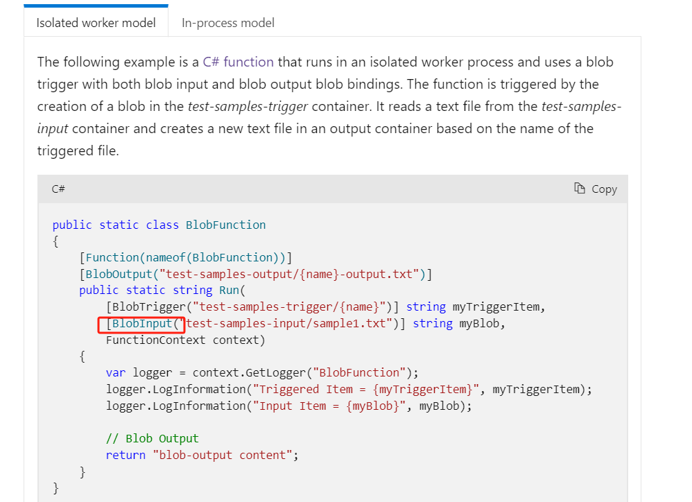

this is our function declaration:
stack error details:
Error converting 1 input parameters for Function 'DistributeBusinessPartner': Cannot convert input parameter 'messageIn' to type 'Azure.Messaging.ServiceBus.ServiceBusReceivedMessage' from type 'System.String'. Error:System.NotSupportedException: Deserialization of types without a parameterless constructor, a singular parameterized constructor, or a parameterized constructor annotated with 'JsonConstructorAttribute' is not supported. Type 'Azure.Messaging.ServiceBus.ServiceBusReceivedMessage'. Path: $ | LineNumber: 0 | BytePositionInLine: 1.
then based on the error message, we fixed the issue by changing the function declaration like below:
but if we change messageIn to string type, meesageIn will only receive the message body instead of the ServiceBusReceivedMessage object, we wanted to confirm if there's a way to let us use ServiceBusReceivedMessage and BlobInput correctly at the same time, or what's the best practice of this case? thank you very much.
https://learn.microsoft.com/en-us/azure/azure-functions/functions-bindings-service-bus-trigger?tabs=python-v2%2Cisolated-process%2Cnodejs-v4%2Cextensionv5&pivots=programming-language-csharp#example
