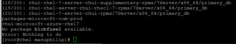

  1. Manu Philip 20,651 Reputation points MVP Volunteer Moderator
    2024-10-28T16:47:05.0266667+00:00
    Hi goutham varma,
    I am able to reproduce the issue you are facing
    However, I am able to resolve the issue with the following steps
    1. Install fuse3 sudo yum install fuse3
    2. Install blobfuse2 with the following rpm sudo rpm -Uvh https://packages.microsoft.com/rhel/7.5/prod/Packages/b/blobfuse2-2.0.3.x86_64.rpm
      1. Finally, you will have blobfuse3 installed
      User's image Hope this helps. --please don't forget to upvote and Accept as answer if the reply is helpful--
