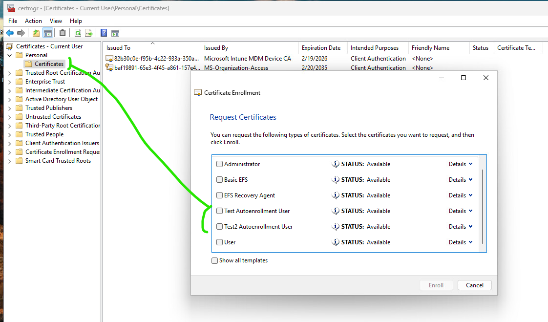

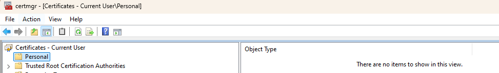

I later on realized that's because the client certificate has been deleted and is not present on the client device:
{6ABD2DCD-98E2-47F2-B385-193E9C0A332F}

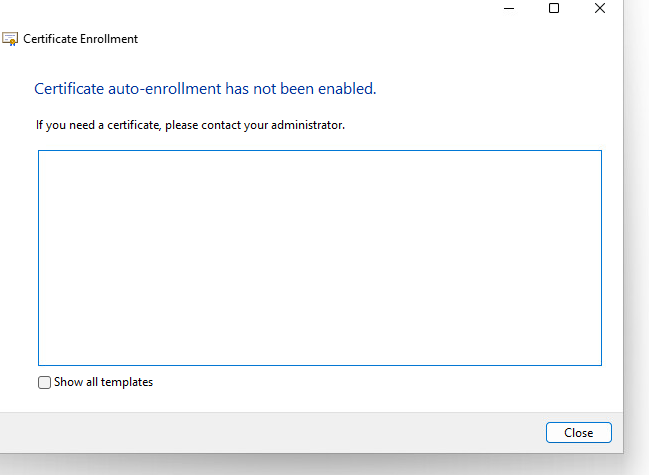

I tried GP update, but the client was not pulling certificate from the CA server.

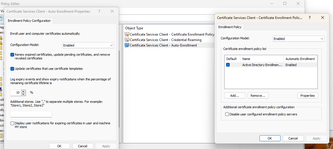

I even tried to set the GPO manually on the client machine to enable the auto enrollment both for user and the computer:
{3BEEB678-0647-4228-928D-37A9A83A61B7}
But I still didn't receive any PKI certificate from the CA server.

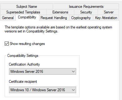

I tried to change the compatibility of the template from the CA server, which did not help :
{CF6BE4AC-1FA0-4CAB-982C-38DD86AFABF4}

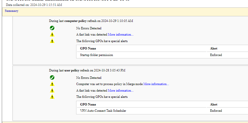

    It sounds like you've been through quite a bit of troubleshooting already! Here are a few additional steps you can try to resolve the certificate auto-enrollment issue on your Windows 11 client:
    1. Refresh Group Policy:
      • Run gpupdate /force on the client machine to ensure that the latest Group Policy settings are applied. Additionally, you can use certutil -pulse to trigger certificate auto-enrollment manually.
    2. Review Event Logs:
      • Check the Event Viewer on the client machine for any errors or warnings related to certificate enrollment.
      • GPresult /H Gpeport.html
      • Is your Group Policy Object (GPO) linked to the specific Organizational Unit (OU) or the domain?
