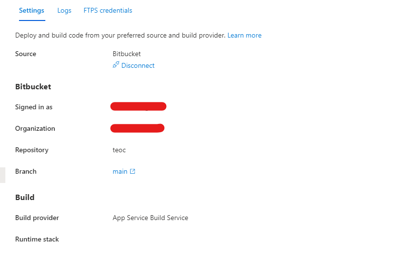

Where we got the GitHub files inside Bitbucket, then I created a new Web App inside Azure, and I defined the Bitbucket repo as the deployment source and i did the deployment. and everything seems to work well.

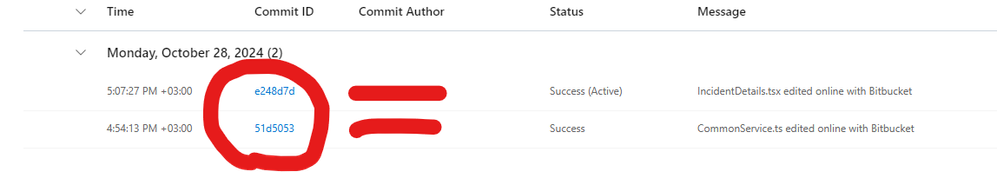

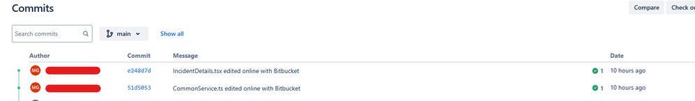

Then today i did 2 modifications/commits to the Bitbucket repo files on the cloud, as follow:-
and i noted that 2 new deployments were executed automatically inside Azure Web App.

    and hence the Azure web App will get a new deployment? If this is the case, then can we prevent this? so we can test any changes done on the upstream before getting them deployed automatically inside Azure Web app?
    Once you have set up Bitbucket as the source control for continuous deployment in App Service, a webhook will be created in Bitbucket to monitor any changes made to the repository. Whenever a commit is made to the repository, webhook will initiate a deployment to app service to make the recent changes available.
    If you want to stop this kind of mechanism instead of adding your bitbucket repo in continuous deployment in app service you need to create the bitbucket pipeline of your own by using different triggers in bitbucket and add the steps which are required to build and deploy your application to app service.
