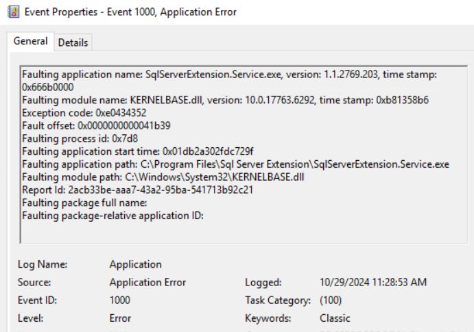

We have two SQL Server 2017 database servers running on Windows Server 2019 Datacenter.
Servers were setup with Always On High Availability (AOHA).
A month ago we started seeing the following error messages in Event Viewer. Both errors show up simultaneously.
What may be causing this service to failed and restart every 5-10 minutes?

    Faced a similar issue, the Service was unable to find the ".SETTINGS" file, this file usually exists in :
    C:\Packages\Plugins\Microsoft.AzureData.WindowsAgent.SqlServer\VERSION\RuntimeSettings\1.Settings
    In my case, it was in:
    C:\Packages\Plugins\Microsoft.AzureData.WindowsAgent.SqlServer\1.1.2769.203\RuntimeSettings\1.Settings
    And for some reason, the SqlServerExtension.Service.exe Service was trying to load an older version 1.1.2735.199.
    You can identify which version is causing the error by stopping the service "Microsoft Sql Server Extension Service" , then going to "C:\Program Files\Sql Server Extension" using CMD and running SqlServerExtension.Service.exe., when doing so, it should point out which version it is trying to load, see this screenshot:
    As you can see, it is trying to load from Agent Version ending with .199 while the latest is 203, I copied the files from 203 to 199 folder and it worked!
