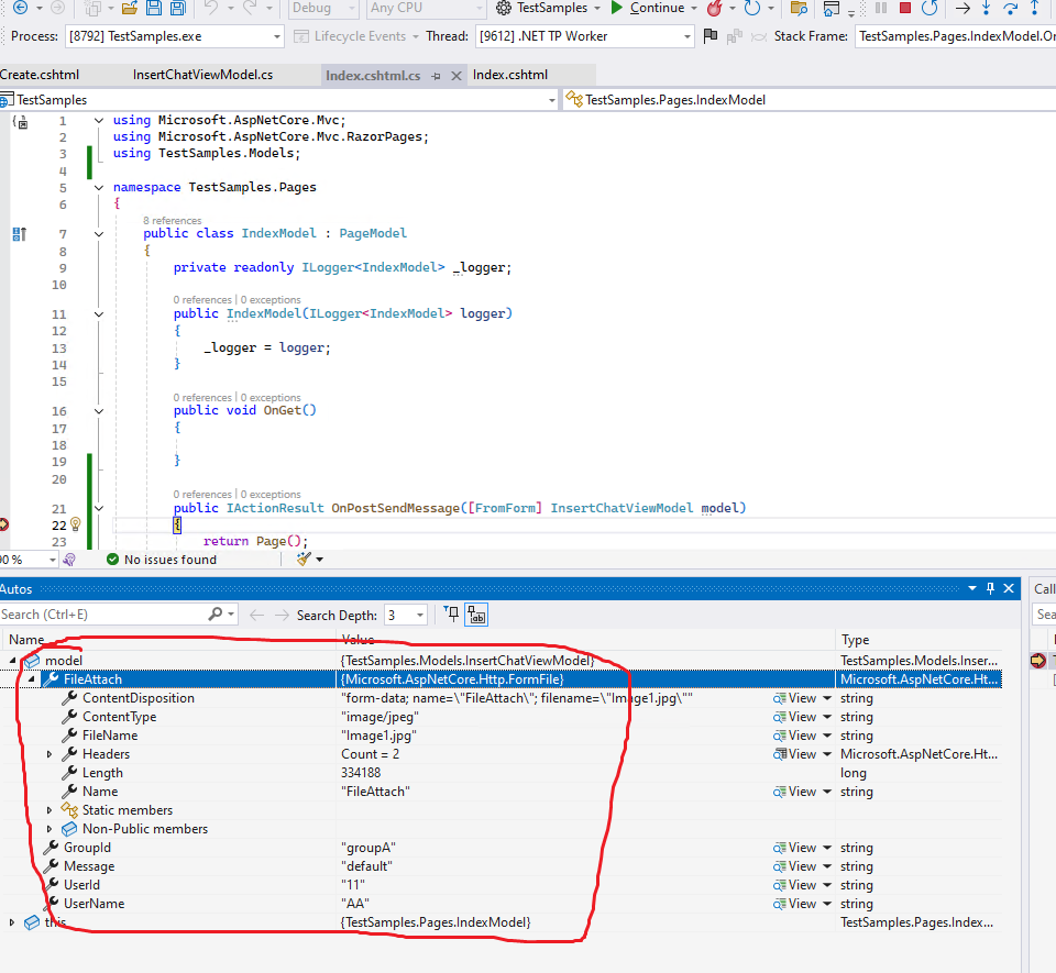

    The result as below:

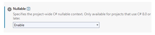

    Please try using nullable reference types for the properties of InsertChatViewModel class

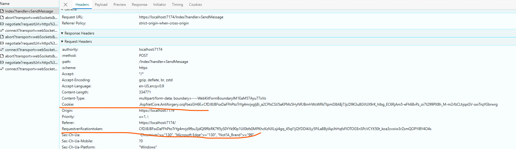

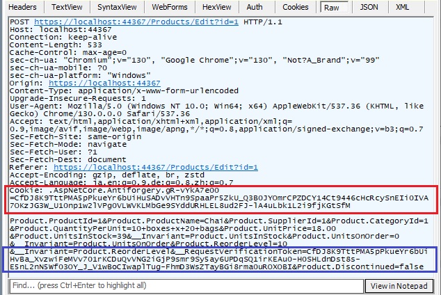

    If the issue is related to anti-forgery tokens as mentioned in the answer form @Zhi Lv - MSFT, both the anti-forgery tokens sent by cookie and hidden field have to be posted to the server as shown in the following figure. Red box includes the token sent by cookie. Blue box includes the token sent by hidden field. Please note that the values are different.
    enter image description here
    To do so, I recommend that you obtain FromData from form element which includes the hidden field for the anti-forgery token as shown below:

    jQuery ajax will post both the tokens sent by cookie and hidden field.
