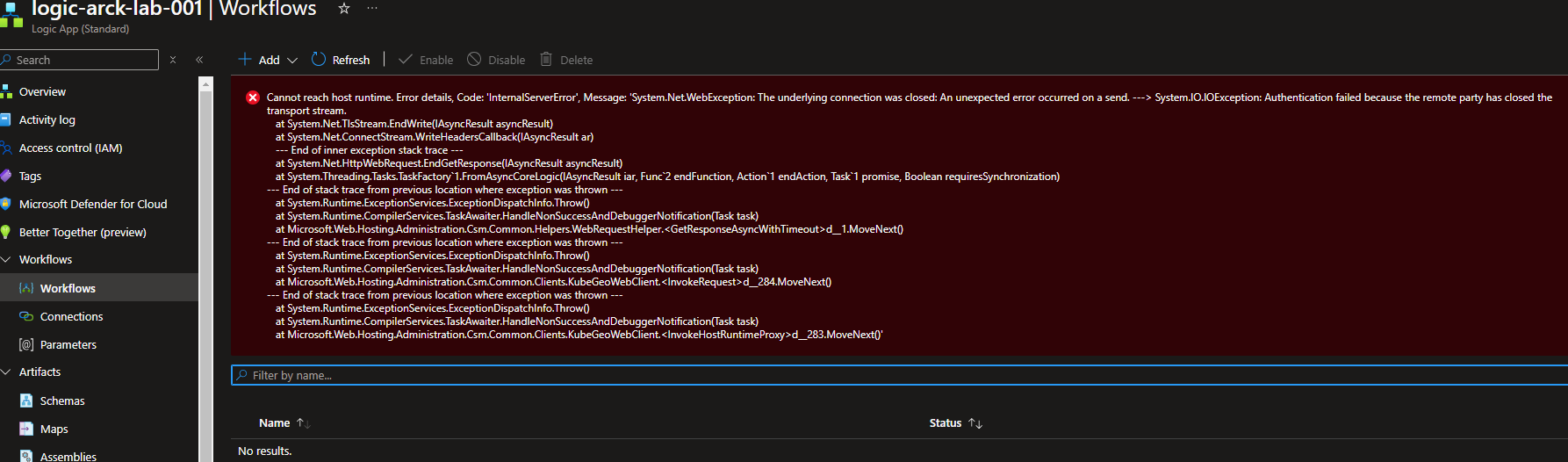

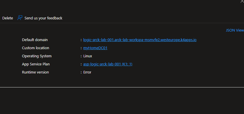

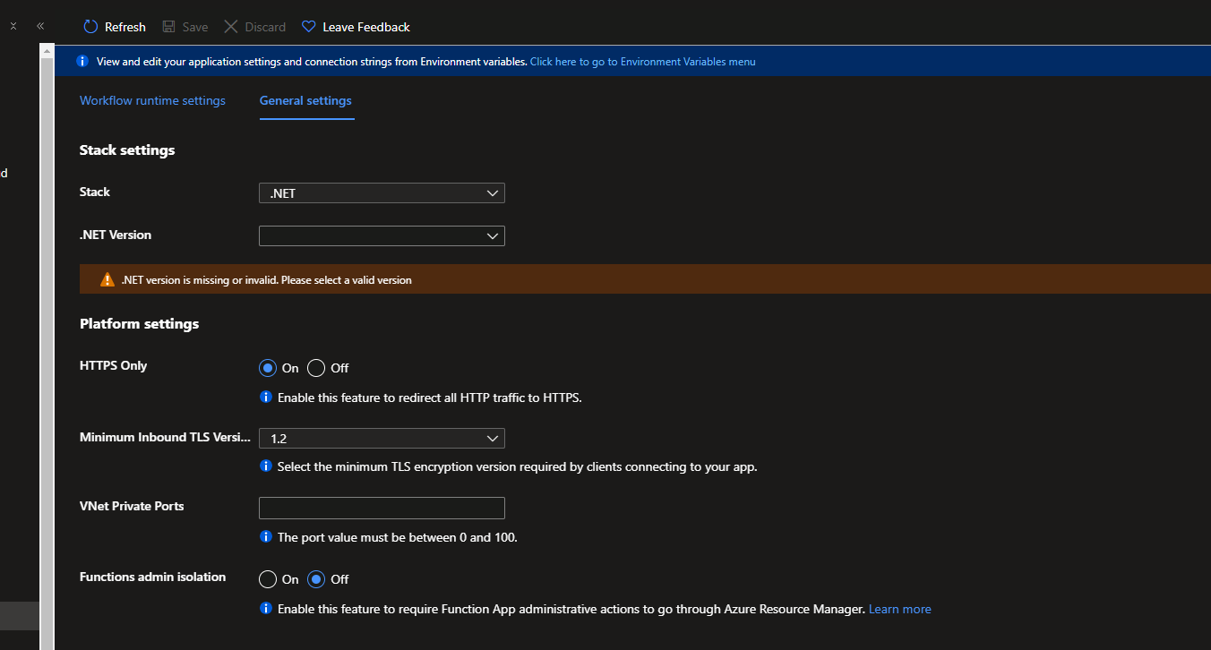

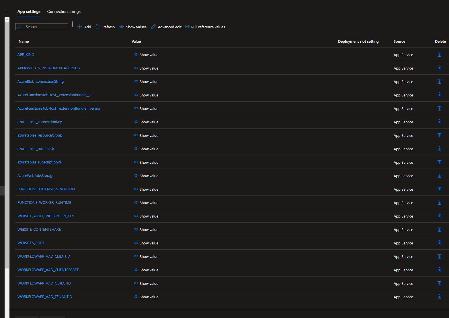

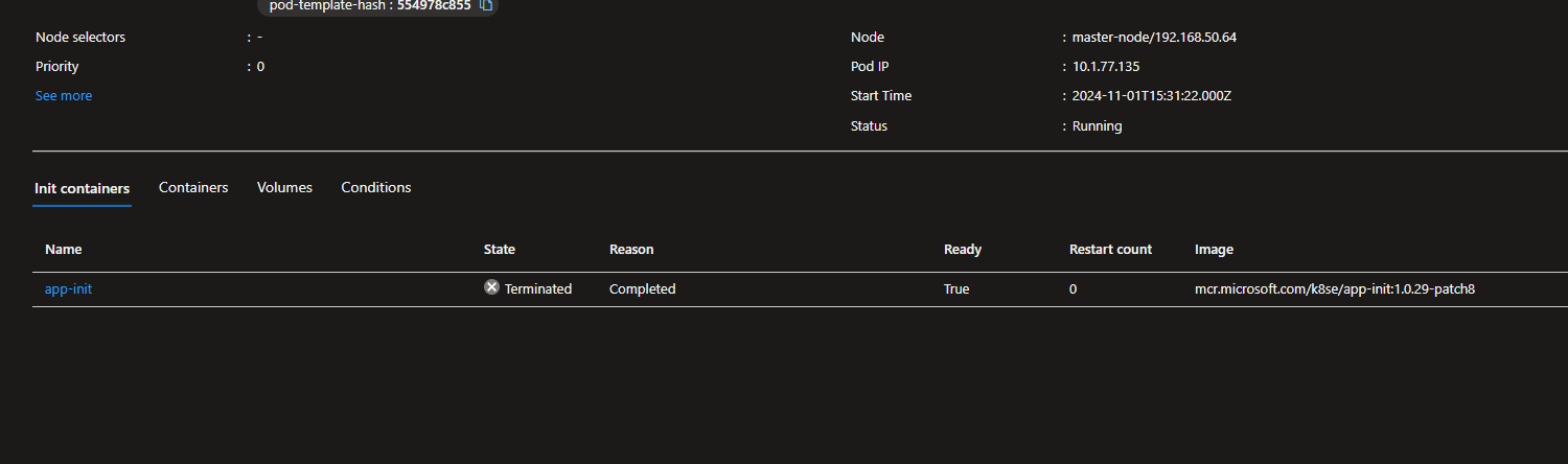

I have issue with deploying logic app in azure arck enabled Kubernetes. I'm using microk8s and it is connected to azure arck enabled Kubernetes and even app service extension and custom location has been created. Web app can be created without any issue but logic app and function app fails. the pods has been created successfully but app-init is terminated and I cannot be able to create a workflow. I have also created a SP and add it to the environment variable but it didn't work.
I followed this documentation to create a logic app: https://learn.microsoft.com/en-us/azure/logic-apps/azure-arc-enabled-logic-apps-create-deploy-workflows?tabs=azure-cli.

    Double-check that the SP you created has the correct permissions and that the credentials are correctly set in the environment variables.

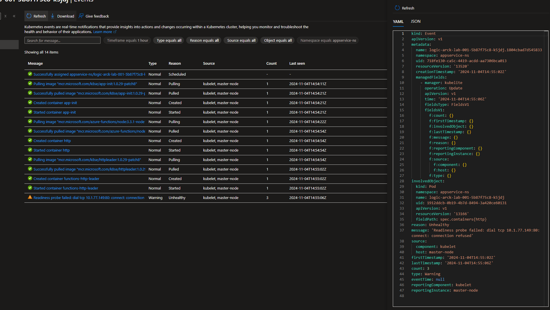

    Examine the logs of the terminated app-init pod to get more information about why it's failing. Use the following command:
    kubectl logs <pod-name> -n <namespace>
    Look for any events related to the pod creation and termination:
    kubectl get events -n <namespace>

    Thanks for responding. I have Double-checked the SP and there is no misconfiguration. The SH has been created by this command:
    az ad sp create-for-rbac -n "JumpstartArcK8s" --role "Contributor" --scopes /subscriptions/$subscriptionId
    Does the SP need an specific rbck role in order to connecting to the storage account?

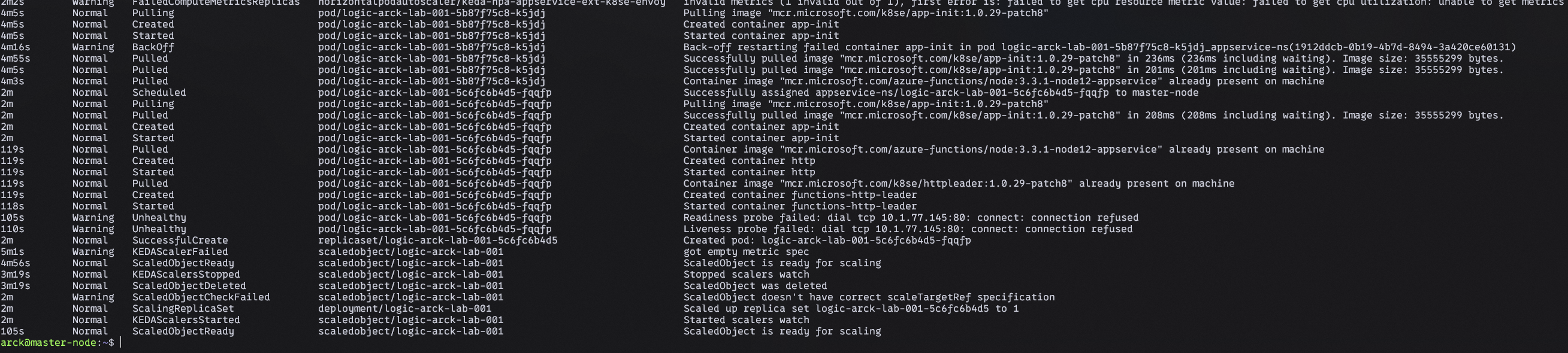

    I have checked the logs and event as you can see in the picture blew.Screenshot 2024-11-04 155721
    Screenshot 2024-11-04 161700
