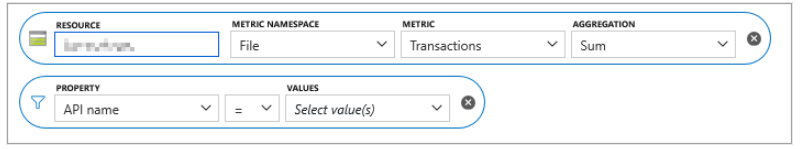

    • Can you please share the screenshot of the metrics?
