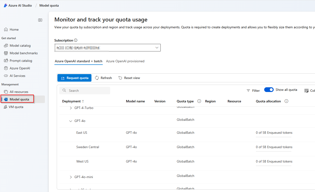

    If you are using Azure AI studio:
    You can view your quotas and limits in Azure AI studio Model Quota section.
    Did you check if you have exceeded the quota limit for your Azure OpenAI resources? You can view your quotas and limits in Azure AI studio Model Quota section.
    Please see Manage and increase quotas for resources with Azure AI Studio for more details.
    You could also try increasing the limit on your deployment.User's image
