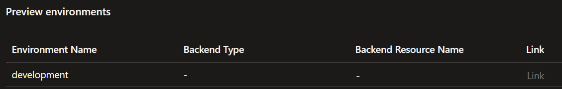

No errors in the pipeline, but the SWA portal app shows I have no backend...
User's imageTrying to hit an api just throws a 404. Everything works fine in local development, so no idea what's going on. I've seen someone with a similar issue who said the answer was to move all dev dependencies to regular dependencies. That didn't work for me... only dev dependencies are typescript and types/node. Another similar issue ended up being the skip_api_build flag. Again, not the issue here.

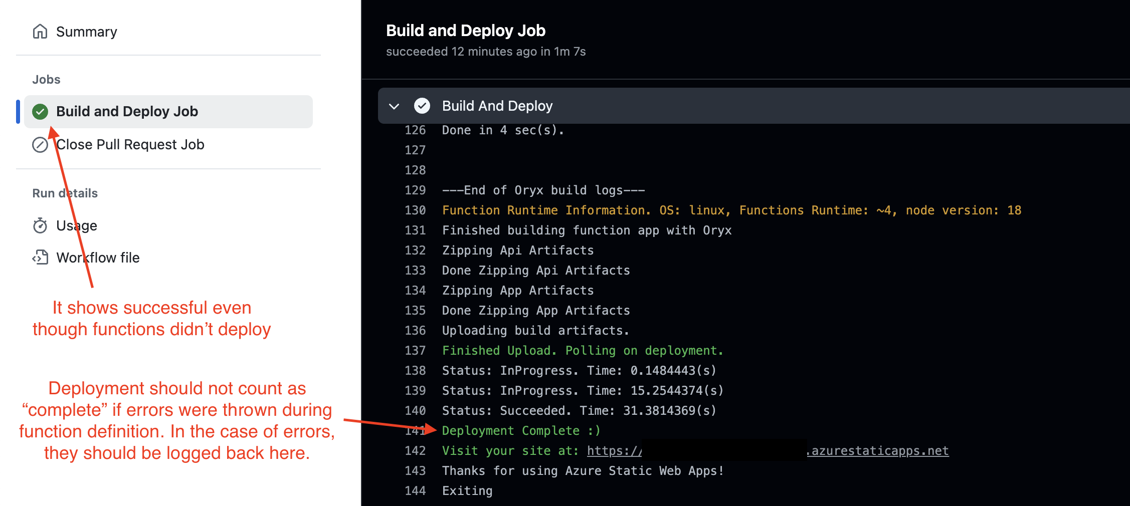

    Annotated screenshot of the deployment logs for a "successful" deploy where functions did not get defined due to an exception getting thrown during function definition:
    Screenshot 2025-01-22 at 7.57.18 PM
    I should note—this is my speculative hypothesis as a user, so I could be missing something, or your problem could be something else, but hopefully there was something helpful in here!
