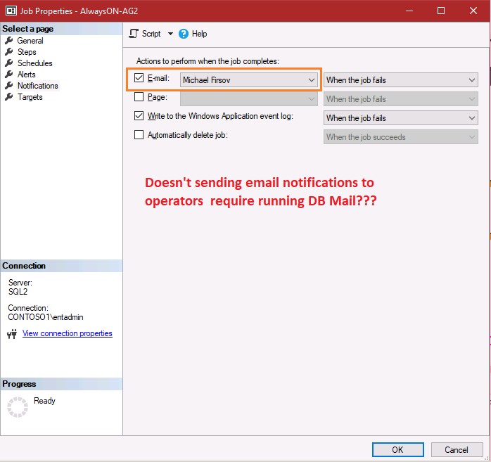

Maybe I forgot something... please help me please to understand the following:
If I have some job that must notify email operator upon its (for example) failure - should these email notifications be sent (and received) if DB Mail is stopped?
01-1
02-1
03-1
04

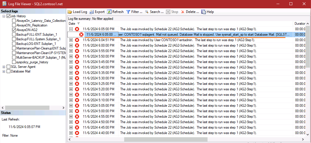

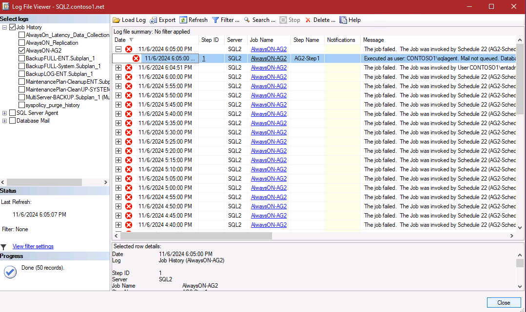

In other words, if - according to the error message in the SQL Agent log - the DB Mail is not working then how do these notifications get delivered to the operator (using the sqlmail account defined in the DB Mail profile)?

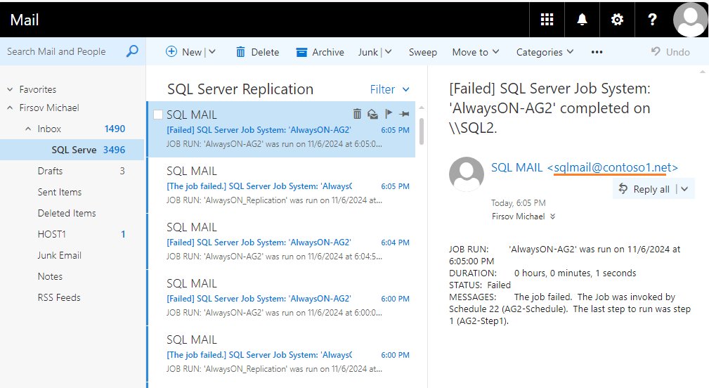

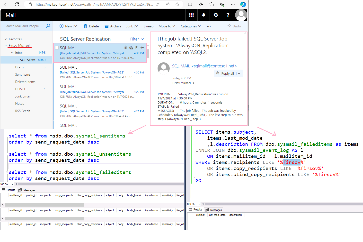

    I've already checked variouse mail-related tables and haven't found any traces of mail messages that keep being delivered to my mailbox (******@contosos1.net):
    N1
    There are lots of messages in my mailbox from ******@contoso1.net while SQL Server knows nothing about them... I really don't get it... :(

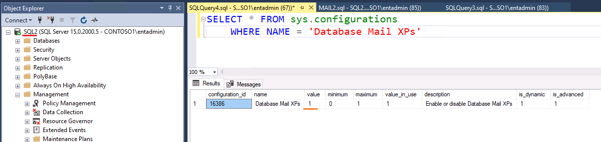

    By the way - DB Mail IS enabled, but SQL Server "thinks" that it is not:
    SQL
