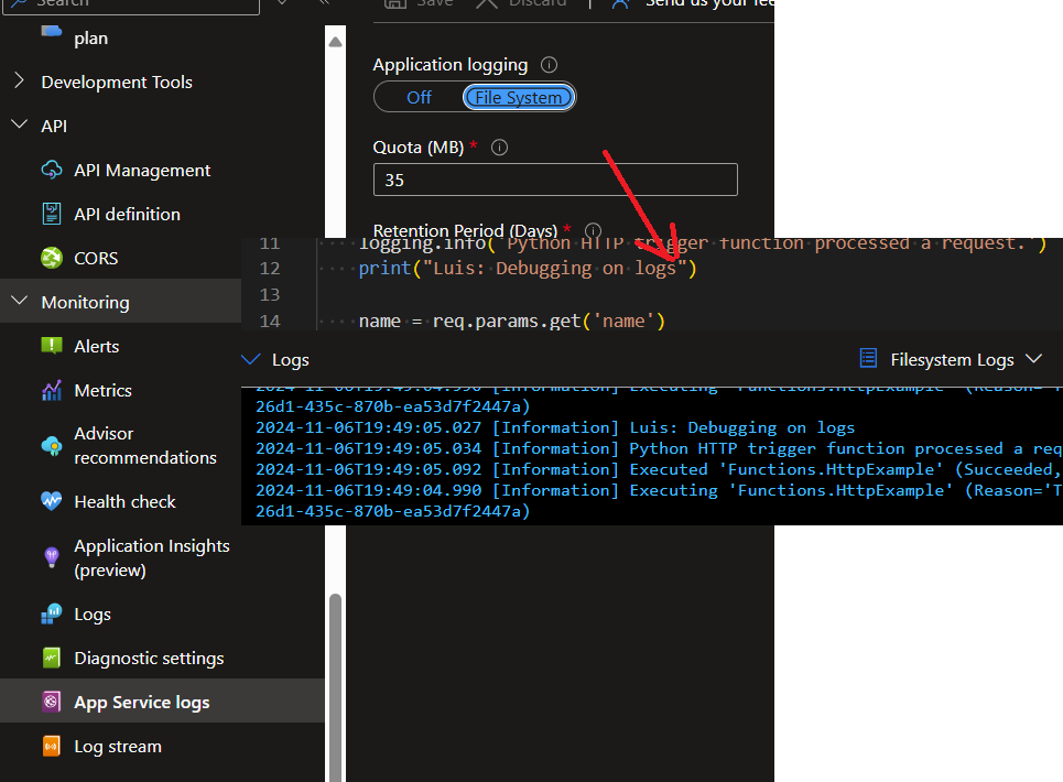

    • Alternative: Log Streaming with App Service Logs (Premium Plans)
      If your Function App is on a Premium Plan, you can enable App Service Logs for log streaming.
      Go to Monitoring > App Service Logs > Enable Application Logging (Filesystem) and set the log level > Use Log Stream to view logs in near real-time. User's image
