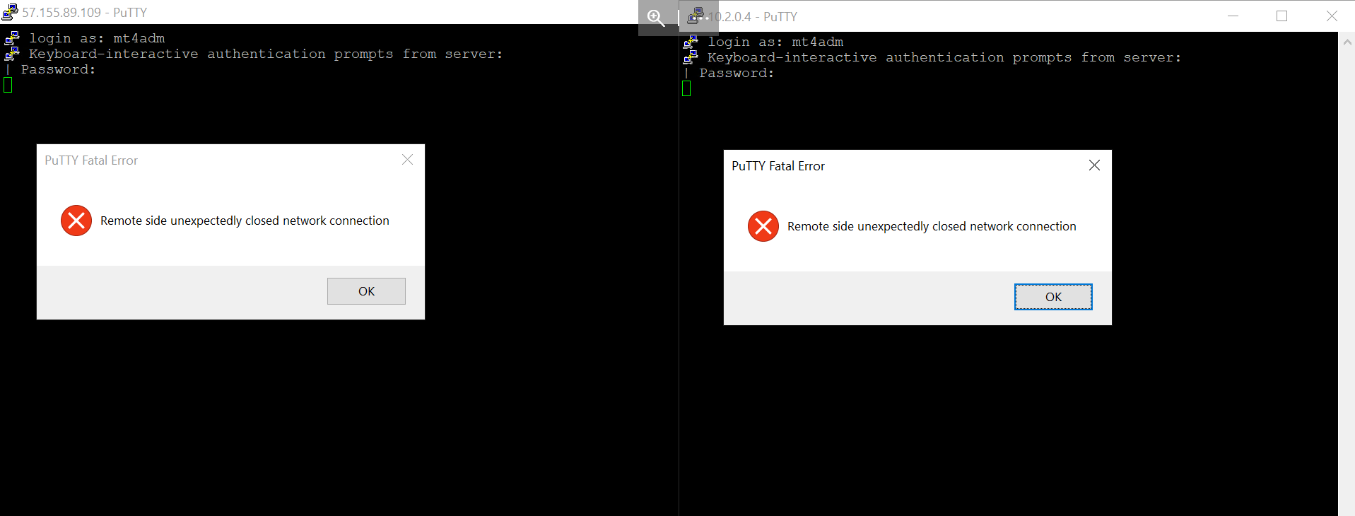

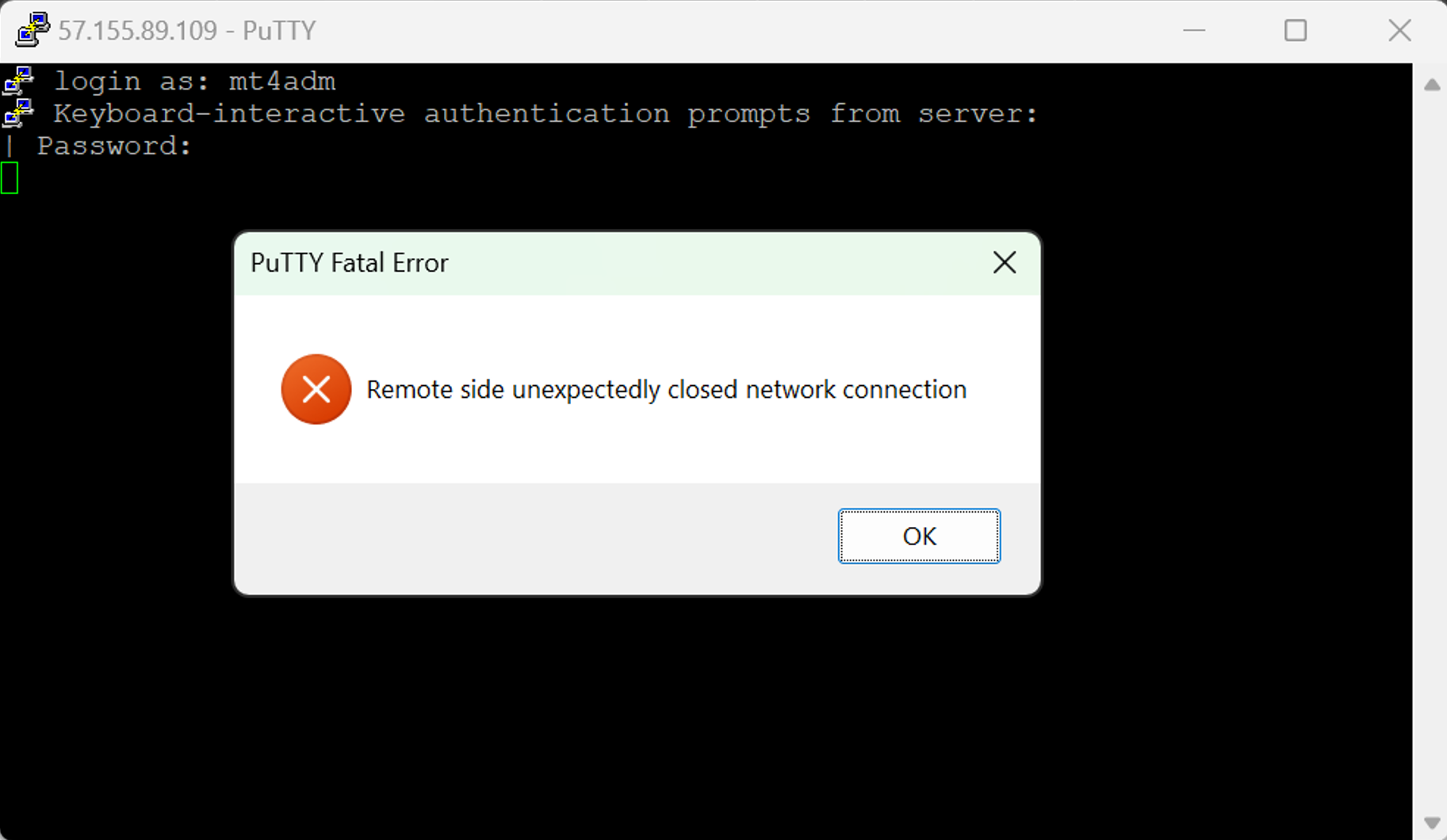

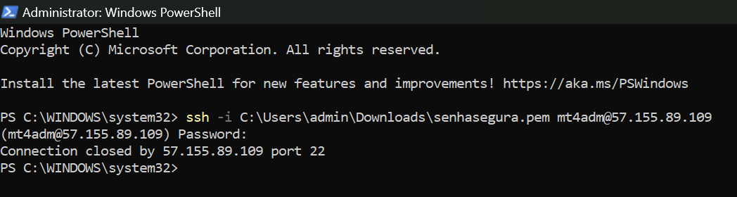

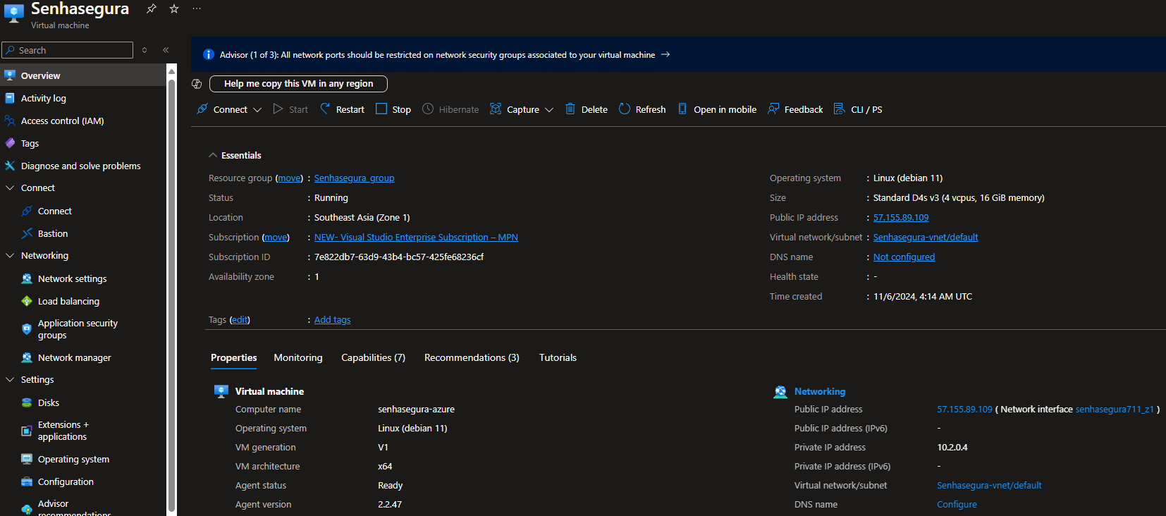

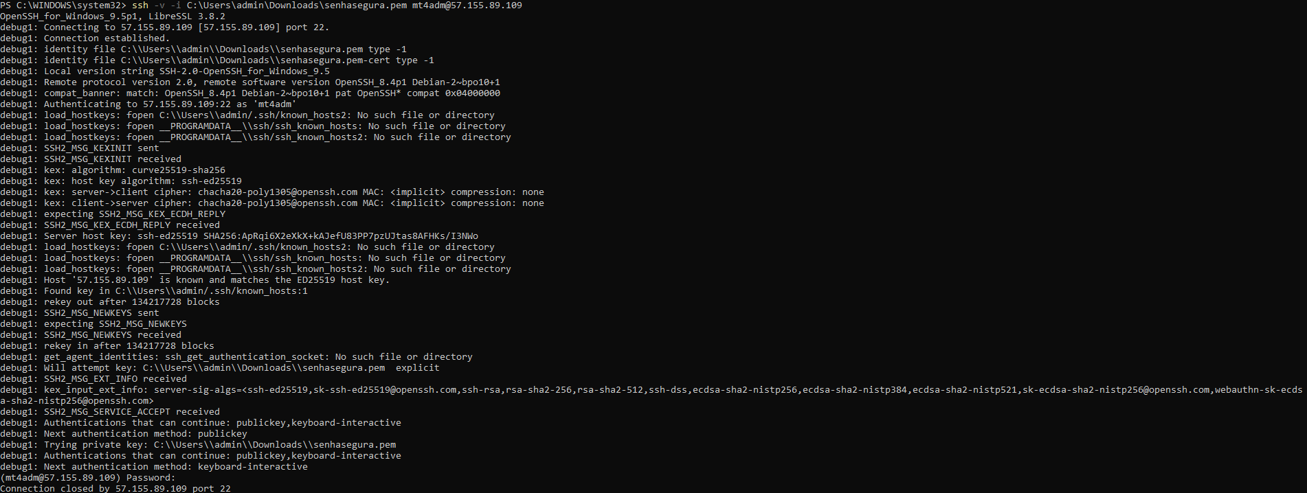

Yesterday I created a Linux VM in Azure and I was able to access it via Putty with port 22. Today, I tried to access with Putty and PowerShell but failed after logging in with the error description as below:
I have tried disabling firewal on my device but still experiencing problems. I also did not make any changes on the Azure network side.

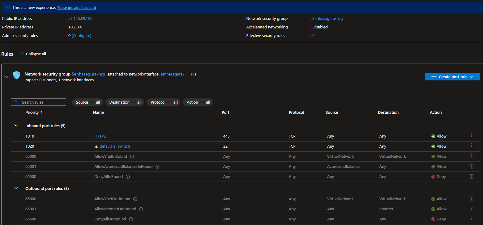

Here is the configuration of the network side in AzureUser's image

    I understand that you are unable to SSH to a Linux VM in Azure.
    From the looks of it,
    • This looks more like a OS related issue than Azure(platform) related
    • When I do a TCP Ping/Telnet to your Public IP on Port 22, I am able to receive a response
      • This means that Azure is not blocking the traffic at platform level
    • I would suggest you post this query in forums related to your Linux distros to get SMEs inputs as well.
    With that said,
    • Are you using Public Key authentication or Passwords? or Both?
    • I see you are using a ".pem" format, but shouldn't Putty be using a ".ppk" format?
      • Can you confirm that you used .ppk key while trying to access via Putty?

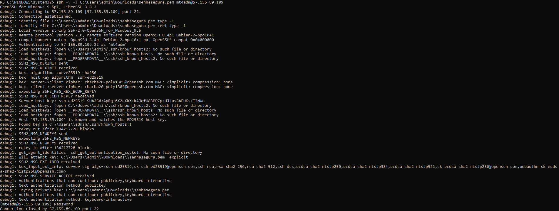

    • Can you run the same command with "-v" parameter for debugging?
      • ssh -v -i "<PathToPrivateKey>" mt4adm@57.155.89.109

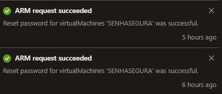

    • If possible, can you try Resetting the password?
      • Either by using Password or adding a new Public Key to the Linux VM

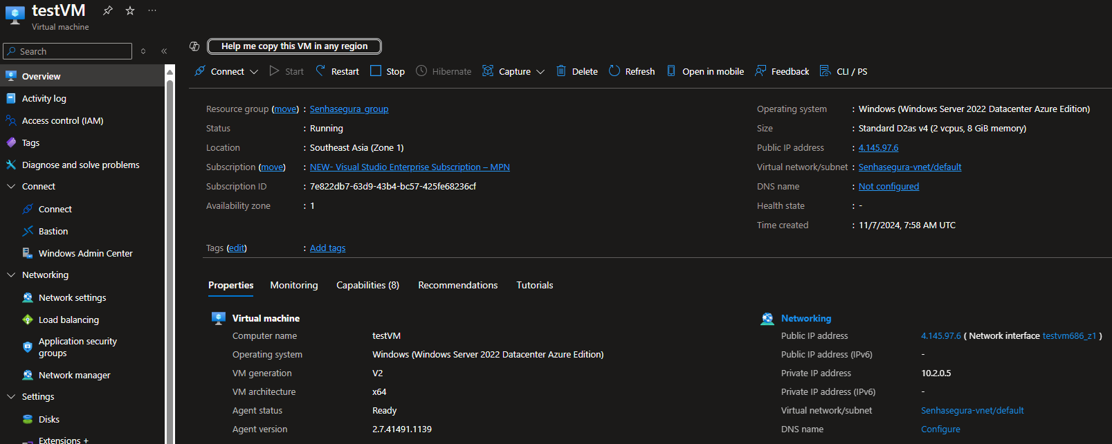

    • Deploy a dummy testVM in the same subnet as the LinuxVM
      • RDP/SSH to this testVM and then try to access the Linux VM from this testVM
      • Does this work? Are you able to access the LinuxVM from the testVM in the same subnet?
