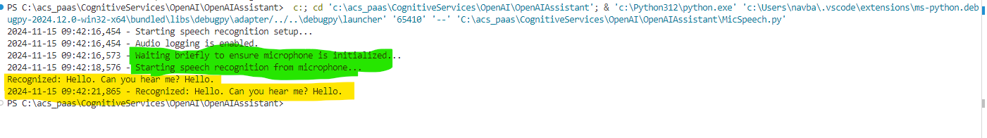

    @Saeshav Subash Thanks for getting back. I tried the same above sample, which you had shared, and it worked fine on my Visual Studio Code. So, I believe this is environment specific and not related to the SDK or Azure speech.
    See below:

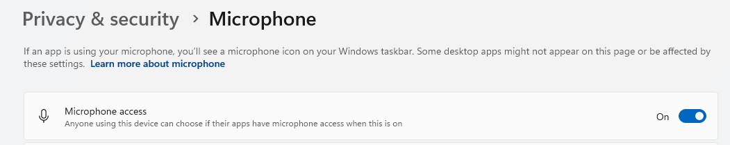

    Plan 1:
    On Windows, make sure that your application has permission to access the microphone. You can check this by going to Settings -> Privacy -> Microphone and ensuring that "Allow apps to access your microphone" is enabled and that Python (or your IDE) is listed and enabled in the app list.
