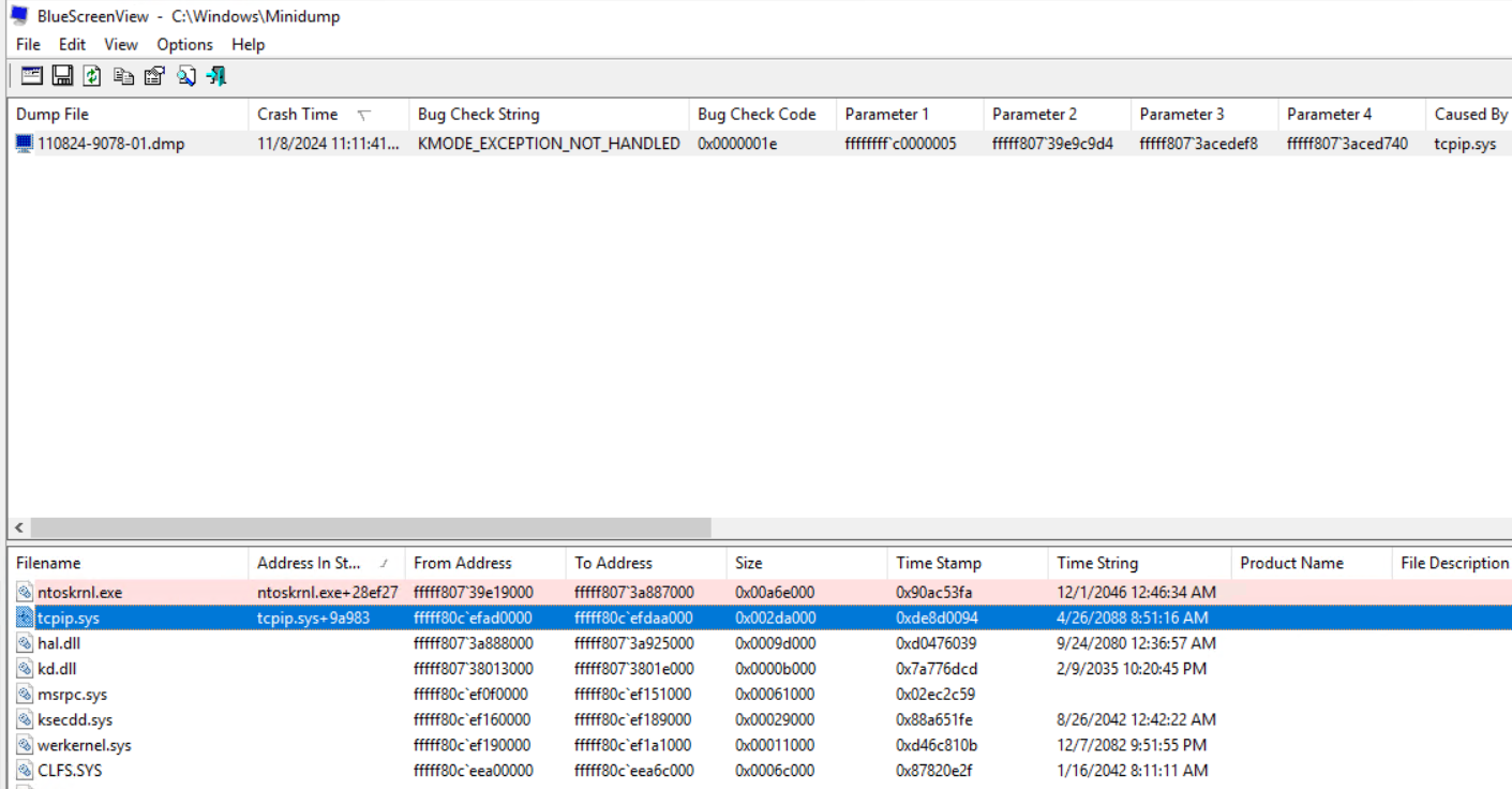

My windows server often rebooted unexpectedly, on the event viewer i can see the computer rebooted due from a bugcheck. Anyone know what exactly happened?
The computer has rebooted from a bugcheck. The bugcheck was: 0x0000001e (0xffffffffc0000005, 0xfffff80739e9c9d4, 0xfffff8073acedef8, 0xfffff8073aced740). A dump was saved in: C:\Windows\MEMORY.DMP. Report Id: 49acb6e1-e657-4cf0-a5cd-6dd1afc123c8.
read by BlueScreenView from Nirsoft and here the result

    This error typically indicates a kernel-mode exception that the error handler did not catch. This can be caused by driver issues, hardware problems, or corrupted system files. Here are some potential solutions:
    1. Update Drivers:
    Ensure all your device drivers are up to date.
    1. Check System Files:
    Use the System File Checker (SFC) tool to scan and repair corrupted system files.
    sfc /scannow
    1. Run Memory Diagnostic Tool:
    Press Win + R, type mdsched.exe, and press Enter. Then choose to restart and check for problems.
    1. Check Hardware:
    Ensure all hardware components are functioning correctly and consider replacing any faulty hardware.
