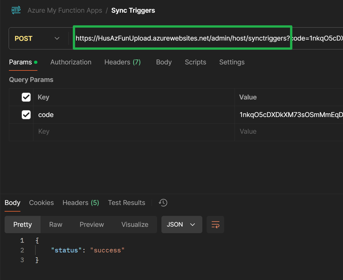

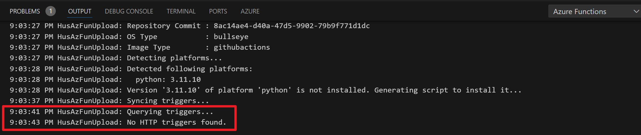

I'm getting No HTTP triggers after deploying Azure logic function, It's operating locally
tried to run sync APIs, but still ..

    @Mohamed Hussein Thank you for reaching out. From the backend logs, I noticed the following error:

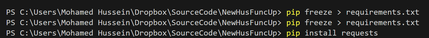

    ERROR: Failure Exception: ModuleNotFoundError: No module named 'requests'. Cannot find module. Please check the requirements.txt file for the missing module. For more info, please refer the troubleshooting guide: https://aka.ms/functions-modulenotfound.
    I recommend checking out this GitHub issue https://github.com/Azure/azure-functions-python-worker/issues/1262#issuecomment-1887742898 and specifically the comments, which might help you resolve the problem. The issue usually relates to the requirements.txt file and the way the imports are listed.
