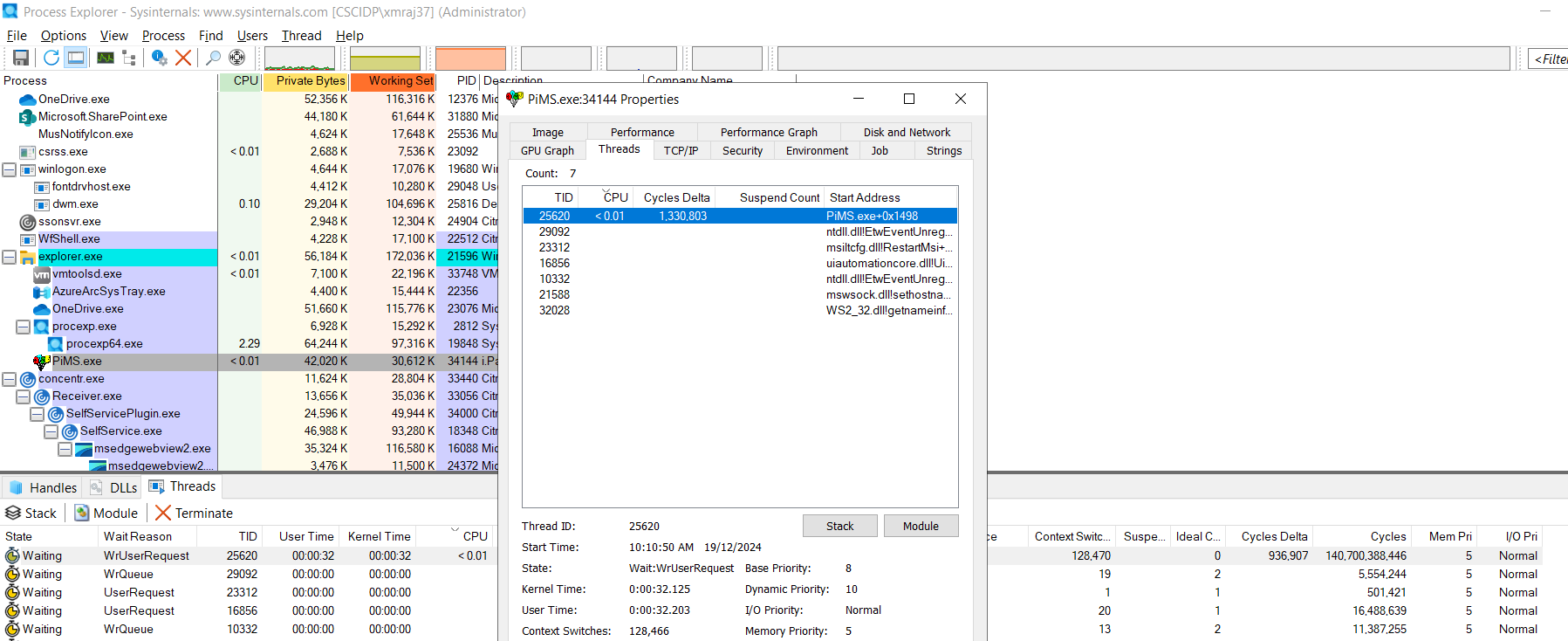

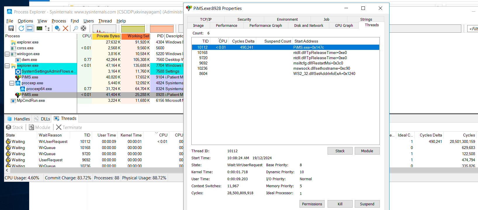

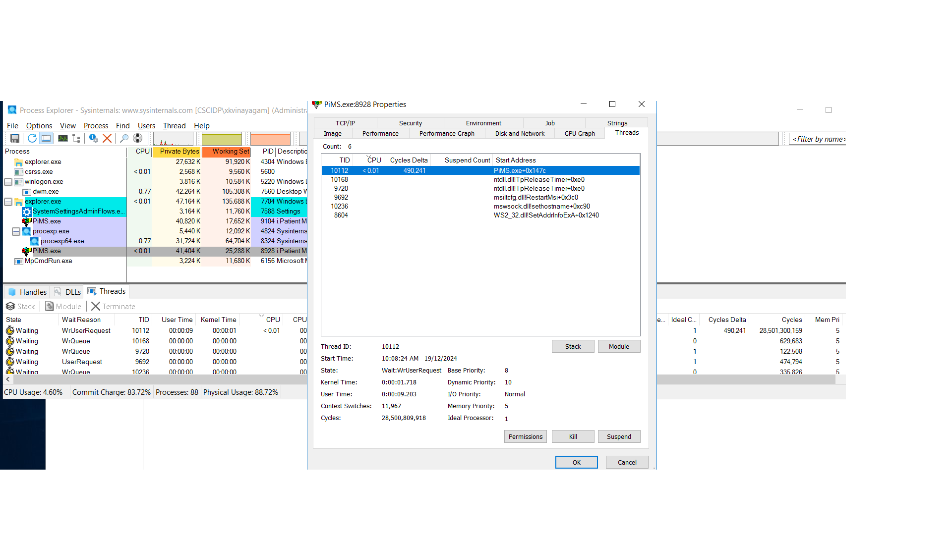

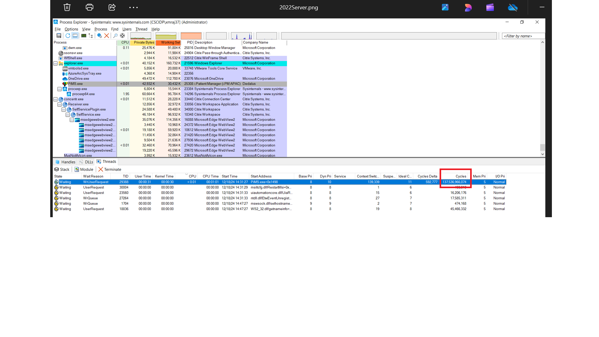

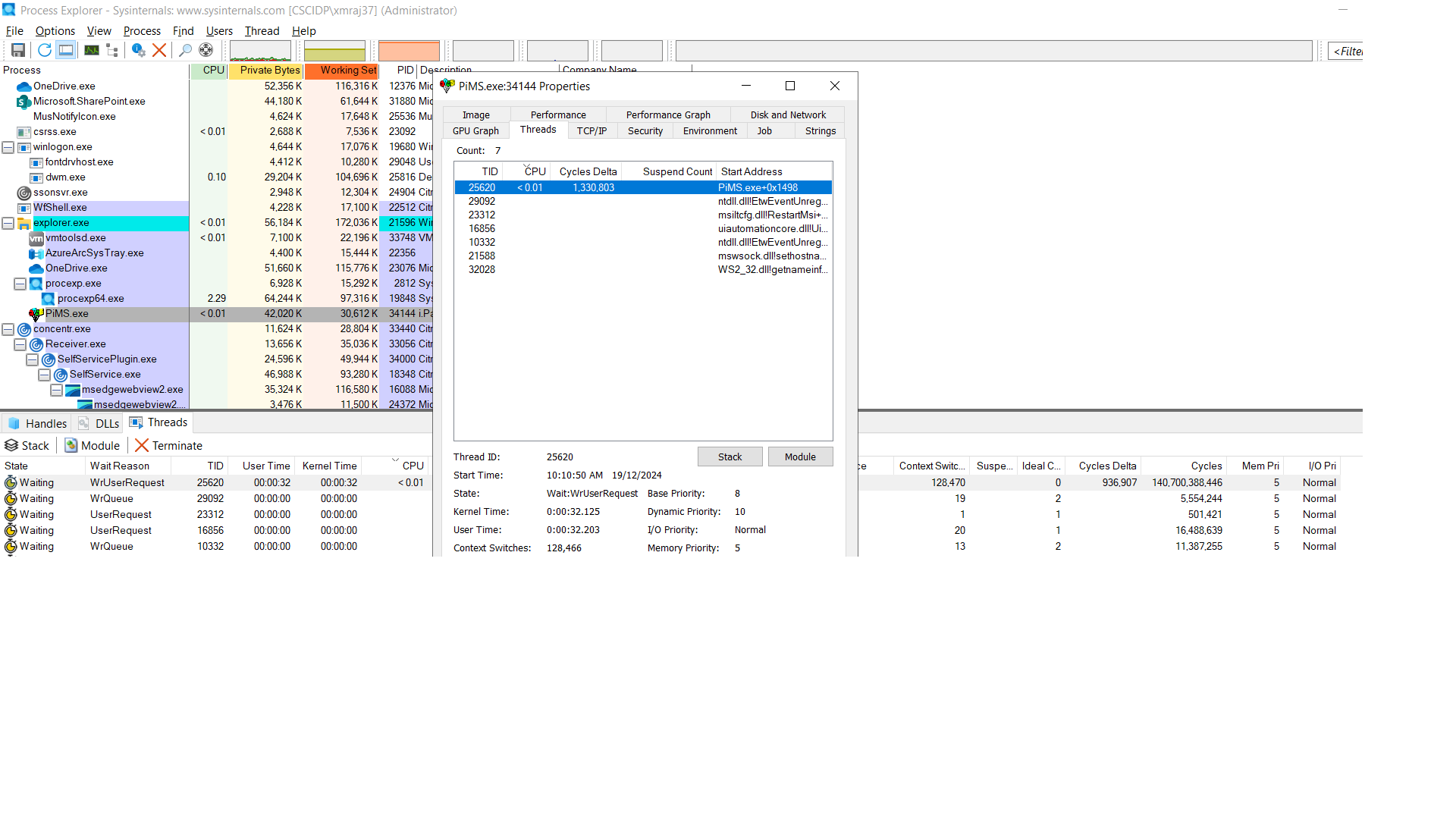

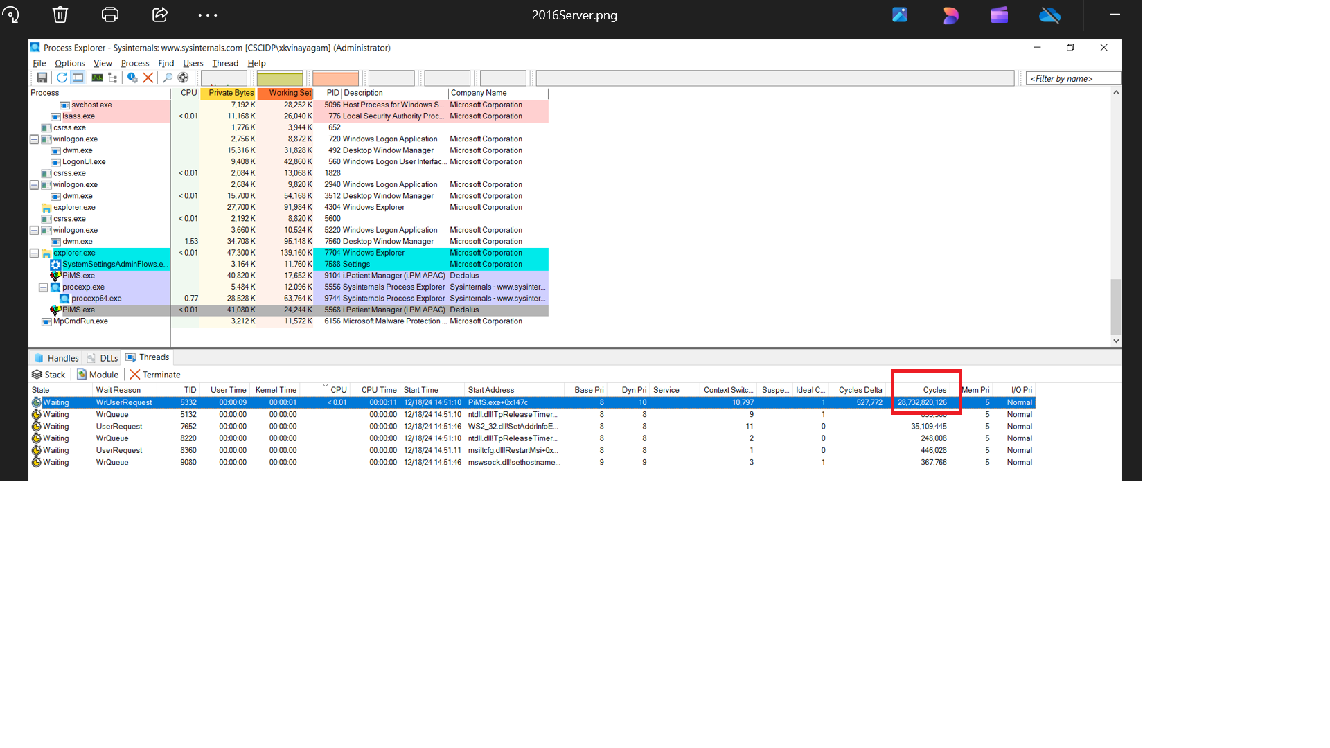

  4. Shankaranarayanan Vinayagam 0 Reputation points
    2024-12-19T03:30:15.09+00:00
    Thank you for the insights. You are absolutely right and since threading has been introduced, it's likely leading to more contention, which is slowing things down despite the reduced CPU usage. As you suggested, closely monitoring the thread counts, CPU usage, and memory usage using tools like Process Monitor and Task Manager,Please find below the screenshot of windows 2016 server and windows 2022 server with thread mechanism using same application and same database.
    Following is the area where Threads waiting excessively on shared resources which could explain the slower thread performance.
    Windows 2016 Server:
    Windows 2022 Server:
    It would be helpful if you could provide information on the difference in cycles when using same application, same connectivity mechanism and same database?
