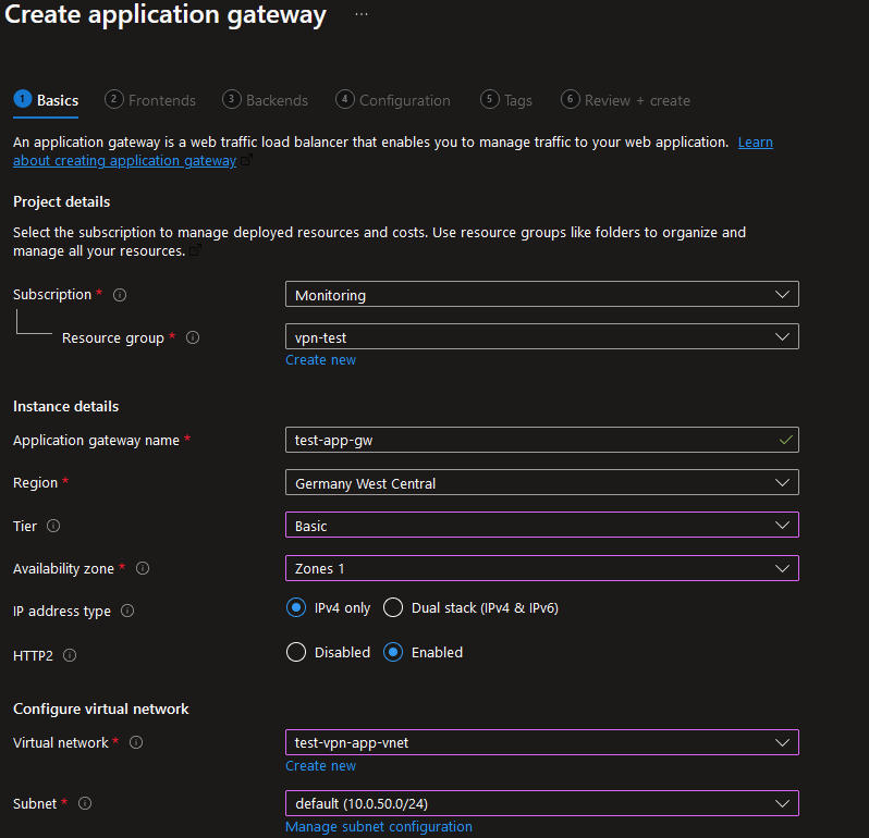

Hey,
I created a test project utilizing an Azure Application Gateway, forwarding traffic to a Hello World Container App.
I am confused by the pricing model and I feel its off compared to the calculator and Azure documentation.
The Azure Application Gateway I created is a "Basic" tier in 1 availability zone.
After 2,5 days I accumulated about 10 Euros of cost with basically nobody using it since its just a test page. I can see some minor random requests coming in from people most likely scanning the internet but nothing serious.
I then checked the metrics via the Azure Portal and it says:
  • Capacity units at 0,7 and sometimes at 2,5
  • Estimated billed capacity units 20
When I check the Azure calculator the basic tier Application Gateway is billed at about 20 Euros for a "Small" one. Weird thing is I cannot select Small, Medium or Large when creating the App Gateway in the Azure Portal.
So technically I am right now billed a "Standard v2" Tier, even though I selected the "Basic" version.
What is the issue here? Why is the cost equivalent to a "Standard v2" when only selecting the stripped down "Basic" version?

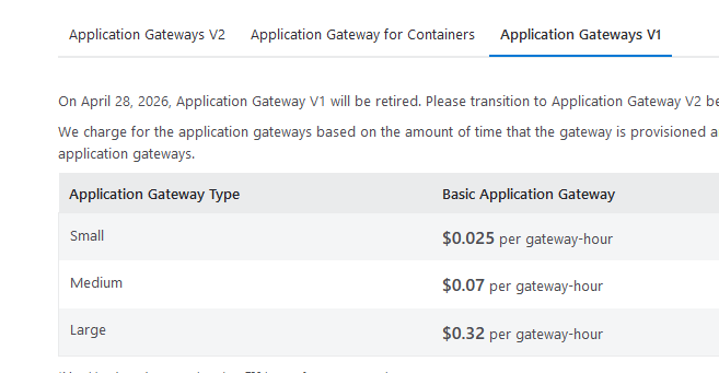

    Azure Pricing Calculator
    I ran into the same issue with the Azure Pricing Calculator when selecting the Tier Basic SKU and given the sizing options for Small, Medium and Large. I believe that the pricing calculator has not yet been updated with the Azure App Gateway v2 Basic SKU pricing.
    But is in fact showing the App Gateway V1 pricing. If you go to the https://azure.microsoft.com/en-us/pricing/details/application-gateway/ and select App Gateway v1, you will see the Application Gateway Types as Small, Medium, Largeimage
