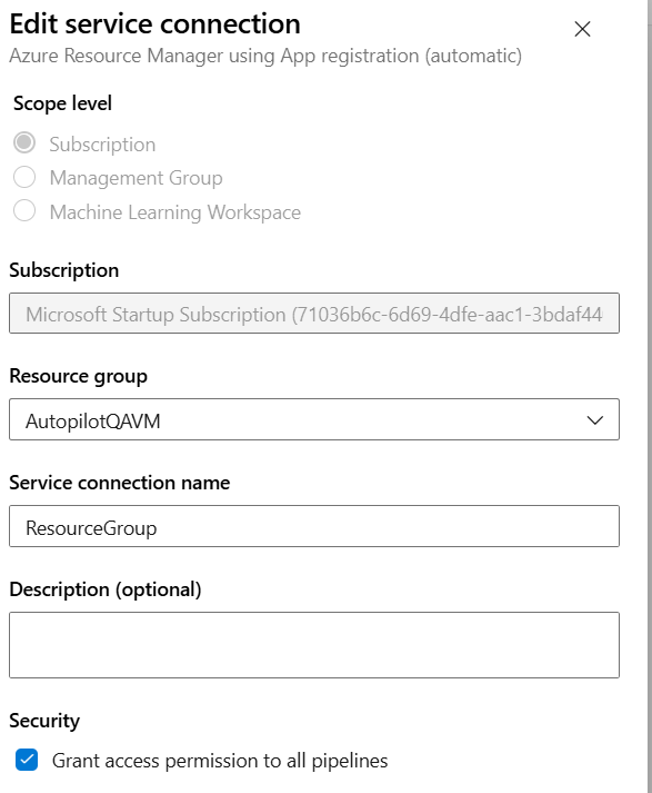

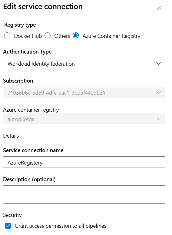

I have created yaml file. i can deploy image to my app service
but i am getting error in pull image
  1. this is my yaml file
       trigger:
         branches:
           include:
             - main # Adjust to your branch name
       pool:
         vmImage: 'ubuntu-latest'
       variables:
         - name: instructor
           value: Arhanti
         - name: imageName
           value: demo
       stages:
         - stage: Build
           jobs:
             - job: CheckAuthentication
               steps:
                 - script: echo "hello [$(instructor)]"
                   displayName: Greetings
             - job: DockerBuild
               steps:
                 - task: Docker@2
                   displayName: 'Docker Login'
                   inputs:
                     containerRegistry: 'AzureRegistery1'  # Ensure this matches your service connection name
                     command: 'login'
                 - task: Docker@2
                   displayName: 'Build Docker Image'
                   inputs:
                     command: 'build'
                     repository: '$(imageName)'
                     Dockerfile: '**/Dockerfile'
                     tags: '$(Build.BuildId)'
                 - task: Docker@2
                   displayName: 'Push Docker Image'
                   inputs:
                     command: 'push'
                     repository: '$(imageName)'   # Same repository path for push
                     tags: '$(Build.BuildId)'  # Use the same tag as in the build step
         - stage: Deploy
           jobs:
             - job: DeployToAppService
               steps:
                 - task: AzureWebAppContainer@1
                   displayName: 'Deploy Docker Image to Azure App Service'
                   inputs:
                     azureSubscription: 'ResourceGroup'  # Azure subscription connected service name
                     appName: 'MySpringApp'  # Name of your Azure App Service
                     imageName: '$(imageName):$(Build.BuildId)'  # Full path with tag for App Service deployment
                     registryUrl: 'https://autopilotqa.azurecr.io'
                     dockerRegistryEndpoint: 'AzureRegistery1'  # Service connection to the Azure Container Registry
                     enableSystemAssignedManagedIdentity: true  # Ensures App Service uses managed identity
    1. i get this error:024-11-12T13:36:06.239Z INFO - Pulling image: demo:125 2024-11-12T13:36:06.841Z ERROR - DockerApiException: Docker API responded with status code=InternalServerError, response={"message":"Head "https://registry-1.docker.io/v2/library/demo/manifests/125": unauthorized: incorrect username or password"} 2024-11-12T13:36:06.844Z ERROR - Pulling docker image demo:125 failed: 2024-11-12T13:36:07.858Z ERROR - DockerApiException: Docker API responded with status code=NotFound, response={"message":"pull access denied for demo, repository does not exist or may require 'docker login': denied: requested access to the resource is denied"} 2024-11-12T13:36:07.859Z WARN - Image pull failed. Defaulting to local copy if present. 2024-11-12T13:36:07.861Z ERROR - Image pull failed: Verify docker image configuration and credentials (if using private repository) 2024-11-12T13:36:13.261Z INFO - Stopping site myspringapp because it failed during startup.

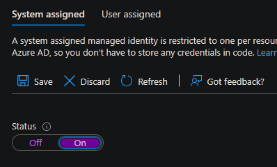

    1. Enable System Assigned Identity by turning the Status to "On" and then select "Yes" on the popup to enable it: image.png

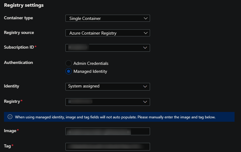

    2. Go to Deployment Center in the Azure Portal and enter the details needed - ensure that Authentication is set to Managed Identity: image.png

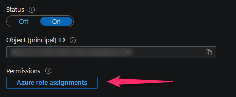

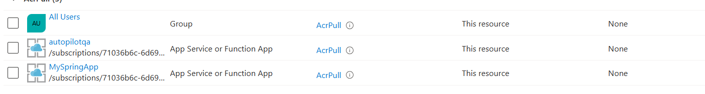

    3. After successfully setting the image and authentication type from the portal, the AcrPull role should automatically be added to this identity. You can validate this by going to the Azure Portal -> Identity -> and click on Azure role assignments: image.png image.png
    4. At this point, the image pull should be successful - this can be validated in Application Logs. For troubleshooting, see the Troubleshooting section below.
