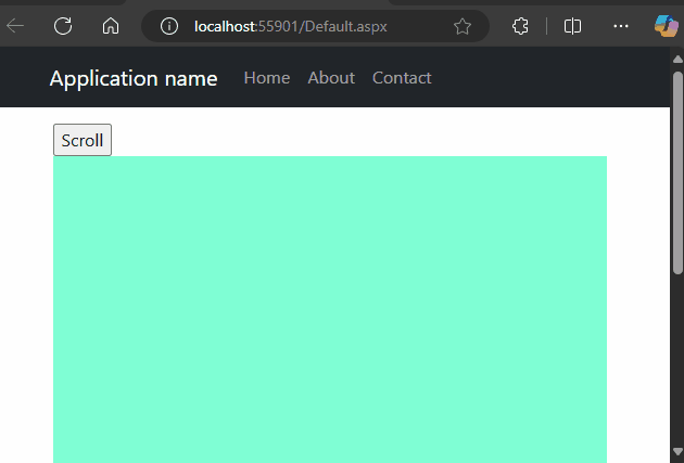

Hello All,
I have an issue with the ASP.Net Web Forms application that is returning an AJAX error when the javascript function is executed. Below is the explanation and code bits to reproduce the error.
  1. Created a Web Forms application with pre-supplied folders & packages, configured for HTTPS
  2. In the default.aspx page added an asp:Button inside an asp:UpdatePanel which should partial post back the web form.
  3. The objective of this asp:Button is to do some business logic on the server-side (C#) and scroll to an HTML <div> on the client-side (JavaScript)
  4. Executed the application. However, it's not working as expected.

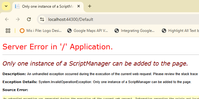

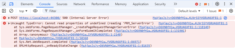

My observation is that It is scrolling to the <div> and immediately loading the form with some AJAX error.
I am not so sure where to start debugging advanced, but I would like to request somebody to help it out.
I've captured a few video bits (less than 1 min play) and screenshots. please check at the link https://1drv.ms/f/c/4f306b866deac618/EiF1VssHtEJFo7RiFlU9eSsBv_FGa1_yA4jnmS7VOdikdw?e=9wBm6l
Error images and code bits follow...
Error1
Error2

    As for the script manager errors? It not at all clear why or how you were receiving as such, but we would need to see the FULL page markup used in that case - including the page header (as above shows, we did not need to add a ScriptManager to the page, since as noted, it is already in the master page).

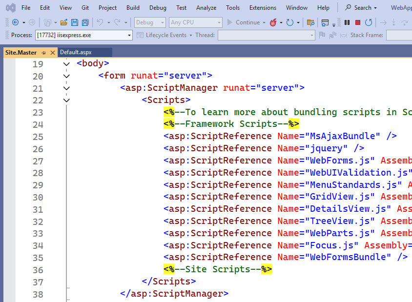

  3. Bruce (SqlWork.com) 84,061 Reputation points
    2024-11-13T21:16:11.7833333+00:00
    when the UpdatePanel makes a ajax callback, the page render does not include the master page (its a partial page render), so on the postback form render there is no script control.
    also you button's onclientclick happens before the postback. so it scrolls the div, but after, the update panel replaces the content, so the scroll will be lost. you will need to tie into the update panel events and do the script after the update is complete via the javascript Sys.WebForms.PageRequestManager object:
    https://learn.microsoft.com/en-us/previous-versions/aspnet/bb386571(v=vs.100)
