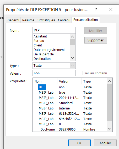

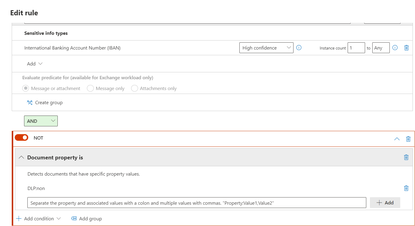

I tried to add a DLP exception rule: if the file has the custom attribute DLP=non, the file will be excluded from my DLP policy. I am attaching a screenshot of my policy along with the custom attribute that I added to a test Word document.
However, the policy did not work

zied berrima • 6 Reputation points
2024-11-18T08:46:41.8566667+00:00 I checked everything; I even considered that the custom attribute might not be readable by the DLP engine. As a result, I thought about using the comment attribute by adding the string 'dlpnon' to it, but the issue persists.
2024-11-27T13:17:07.72+00:00 hello,
After searching , i just find something important to do this ( loocking for support also) : when we put the properties of a file in the dlp policy , that mean the property of the location of the file ( sharepoint/oneddrive) not the properties of the word file like i thought in my publication , so by this way , i need to create a custom column in the SPO library where the file is stored , and make this colum as managed and crowled property to give me the possibility to call this property in my dlp policy : file property section
So i need from you a support/steps to make this working : create custim colum and make this custom column crawled in the sharepoint schema

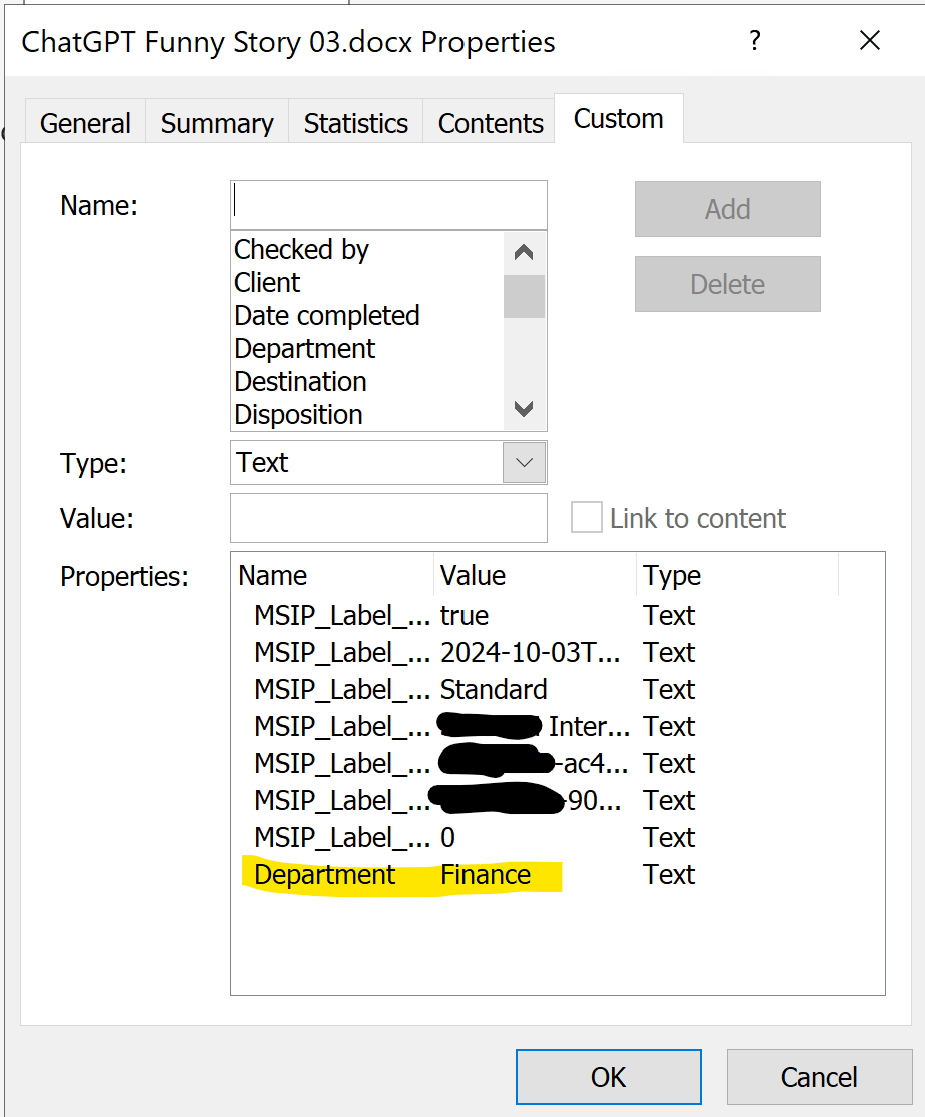

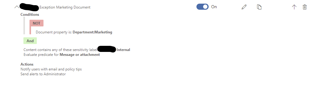

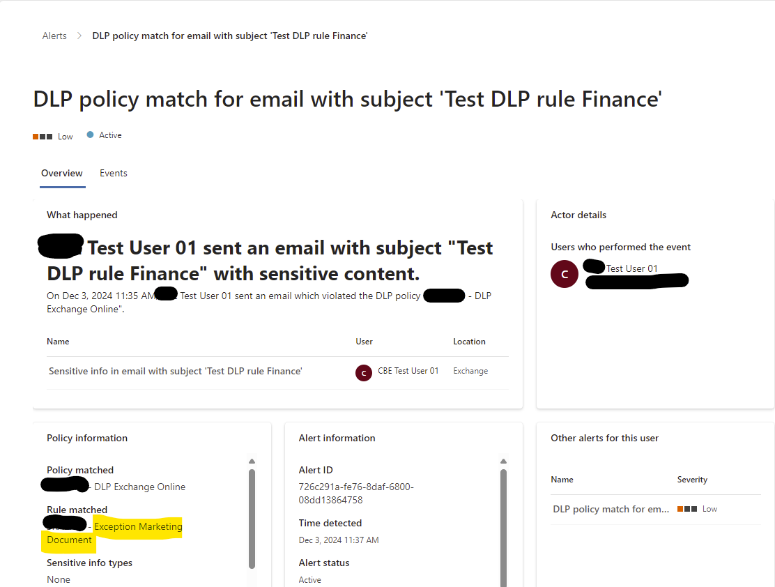

Clément BETACORNE • 2,496 Reputation points
2024-12-03T14:03:15.7933333+00:00 Hi Zied,
I tried on my tenant a configuration with custom attribute into a DLP policy for Exchange Online and it works.
Regards,
