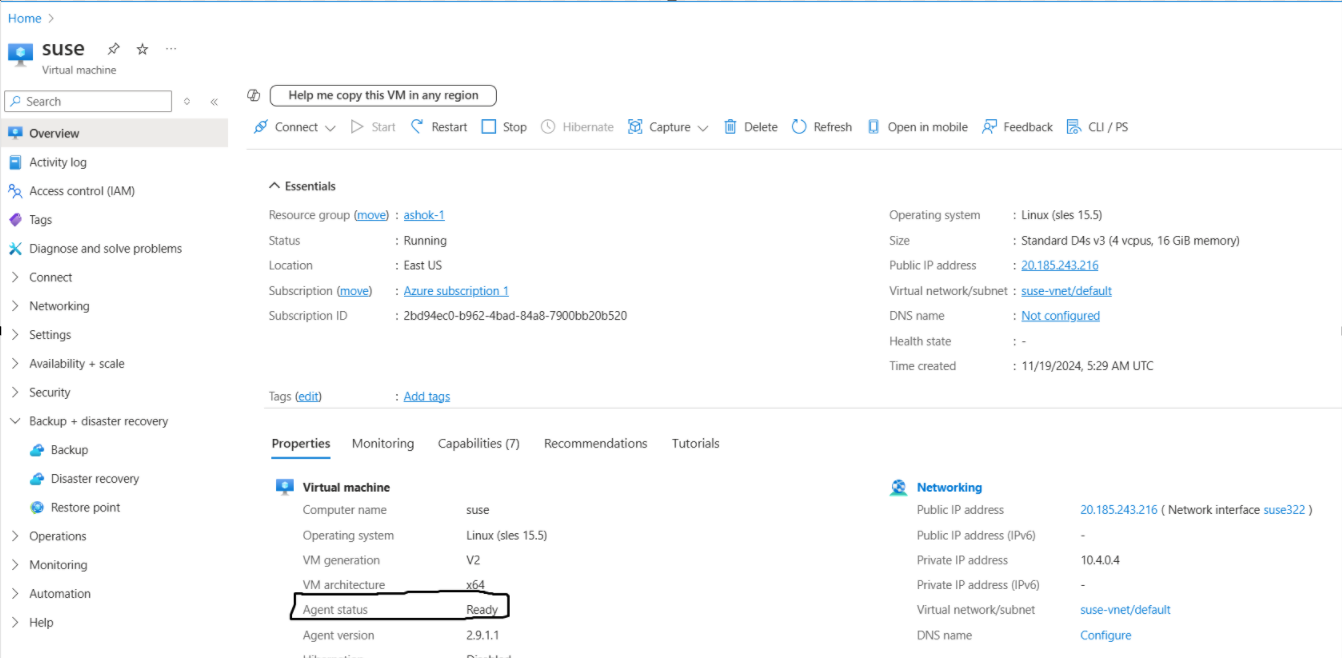

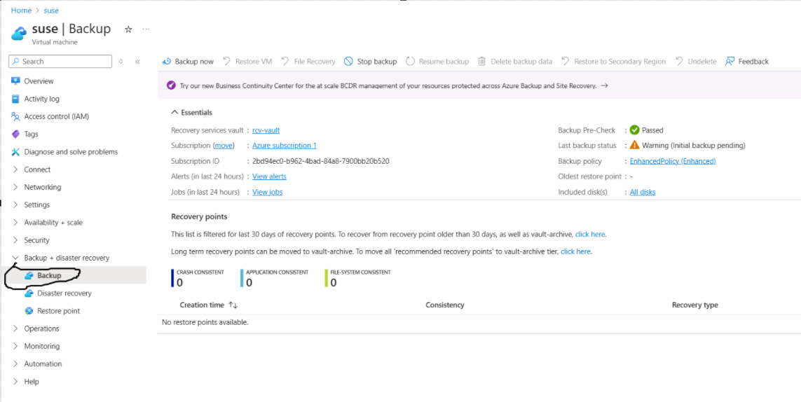

    Please try to enable backup from VM Blade not from the recovery service vault whether you can see the VM or not. and also, please select the enhanced policy not the standard backup policy
    User's image Also please check whether the agent is in ready status or not
