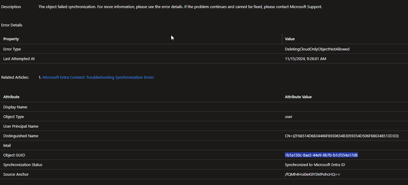

I have a Microsoft Entra Connect Health Sync error with an account that is blank, and I am unable to find it in local AD or Microsoft Entra ID to delete it and resolve the sync error. How can delete this blank user object?
The object failed synchronization
Display Name: (Blank)
Object Type: user
User Principal Name: (Blank)
Distinguished Name: CN={2F66514D6834486F6930654B3059354D506F686348513D3D}
Mail: (Blank)
Object GUID: 5a0af104-2851-4c42-bc01-6a0ffd4374ef
Synchronization Status: Synchronized to Microsoft Entra ID
Source Anchor: /fQMh4Hoi0eK0Y5MPohcHQ==

    I was not able to find the account using the Synchronization Service Manager on my local domain controller. I should have included the error type message of:
    Error Type DeletingCloudOnlyObjectNotAllowed
