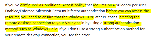

    However, there is a limitation: if a user attempts to connect to RDP while the conditional access policy is in place, they will need to complete the second-factor authentication using a strong authentication method, such as Windows Hello for Business. You can refer to the following document for more details:
    How to enable MFA for Azure AD-based VM sign-ins
    Important Notes:
    • Users with per-user enabled/enforced Azure AD Multi-Factor Authentication are not supported for VM sign-ins.
    • If a user is subject to a conditional access policy that requires MFA and the Windows Hello for Business certificate trust model has not been deployed, the sign-in will be blocked until the "Azure Windows VM Sign-In" application is excluded from the list of cloud apps that require MFA.
