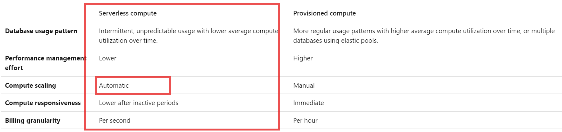

    Please note that, The following table summarizes distinctions between the serverless compute tier and the provisioned compute tier:
    Compare compute tier Auto-pause troubleshooting: If auto-pausing is enabled and features that block auto-pausing are not used, but a database does not auto-pause after the delay period, then application or user sessions might be preventing auto-pausing.
