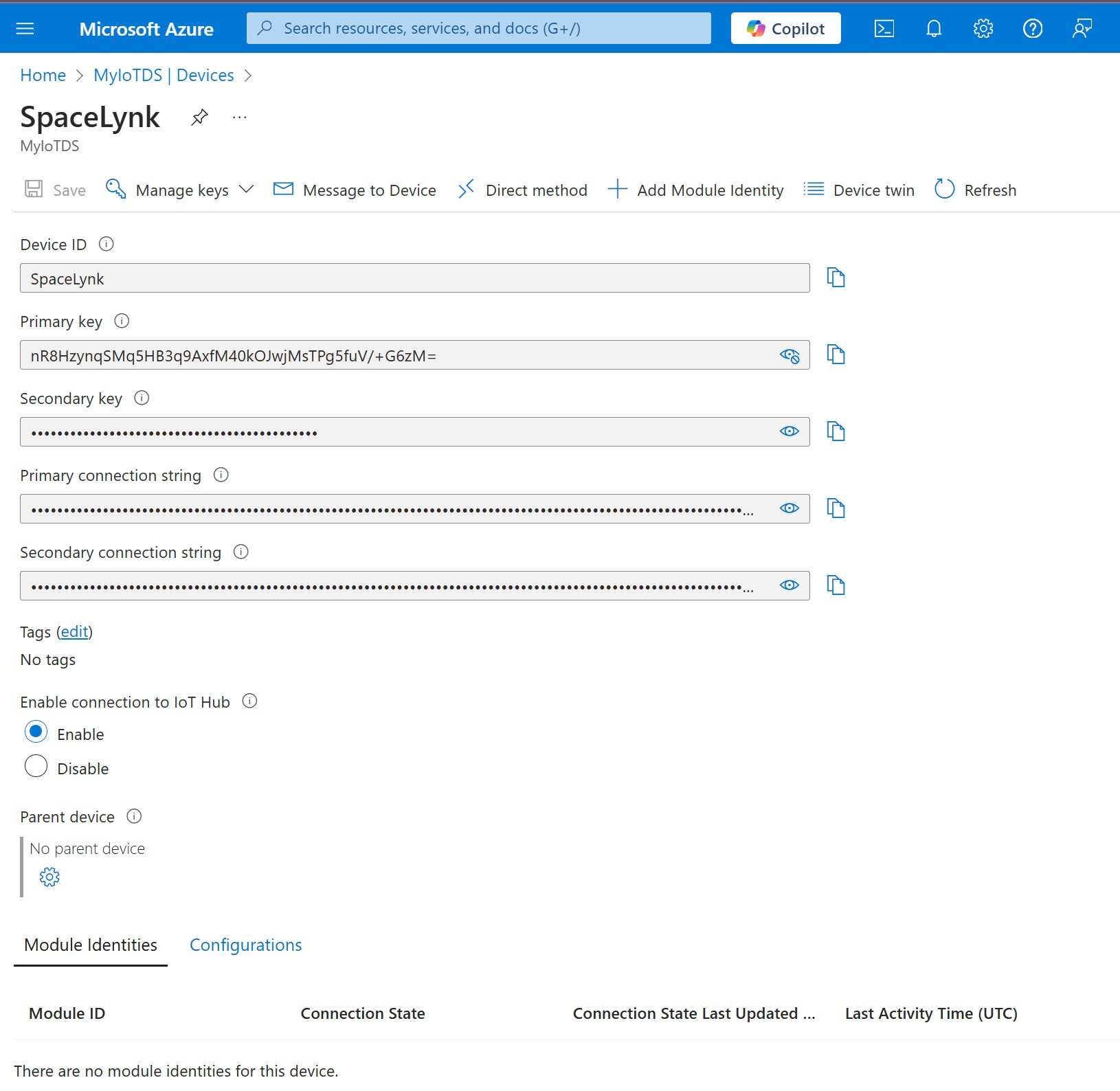

Hello everyone. I want to ask a question regarding an issue that I've been dealing with. I am trying to connect a Schneider SpaceLYnk device to my MS Azure IoT hub through a LUA script using mosquitto. However it does not seem to connect. Does anyone know if the script is correct or if I am entering the right details? Thank you

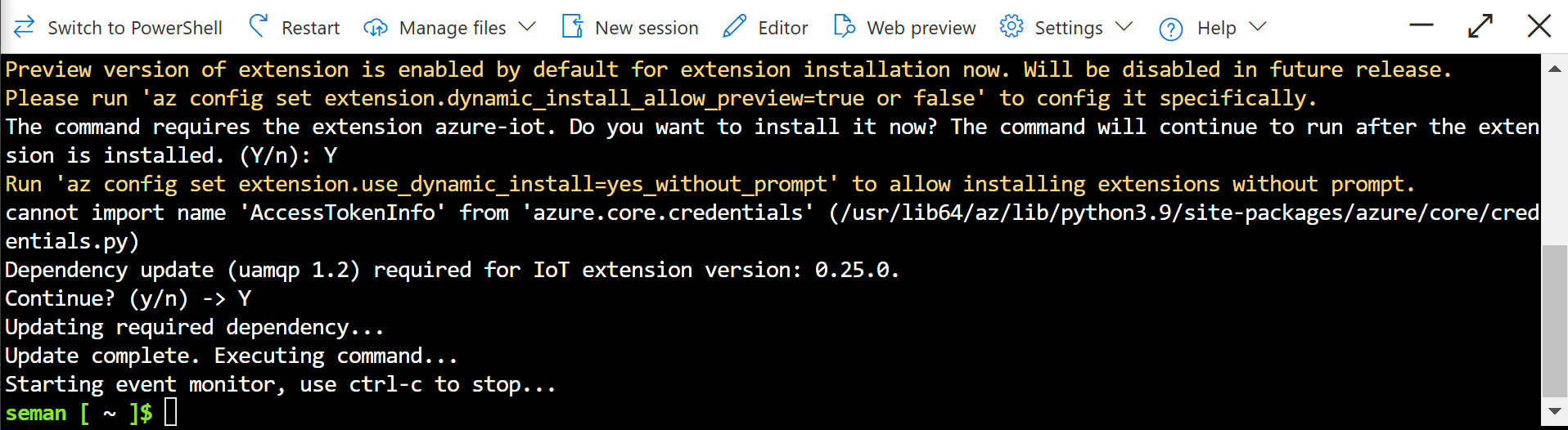

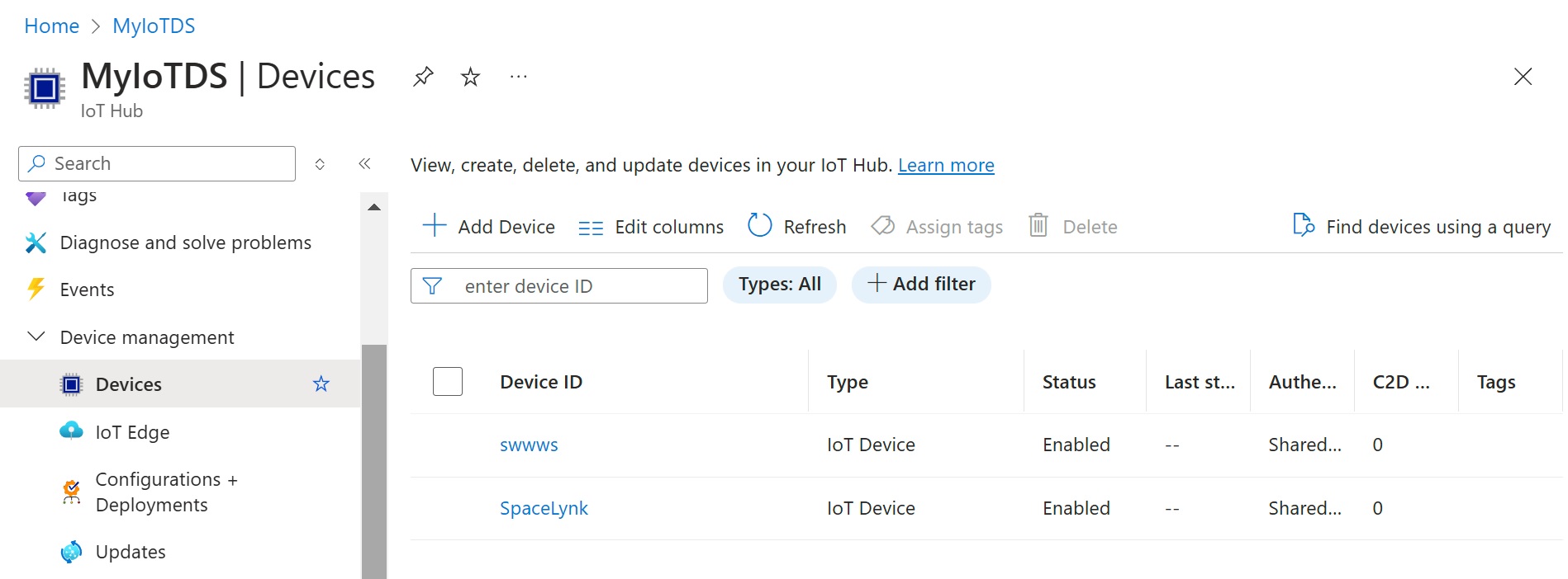

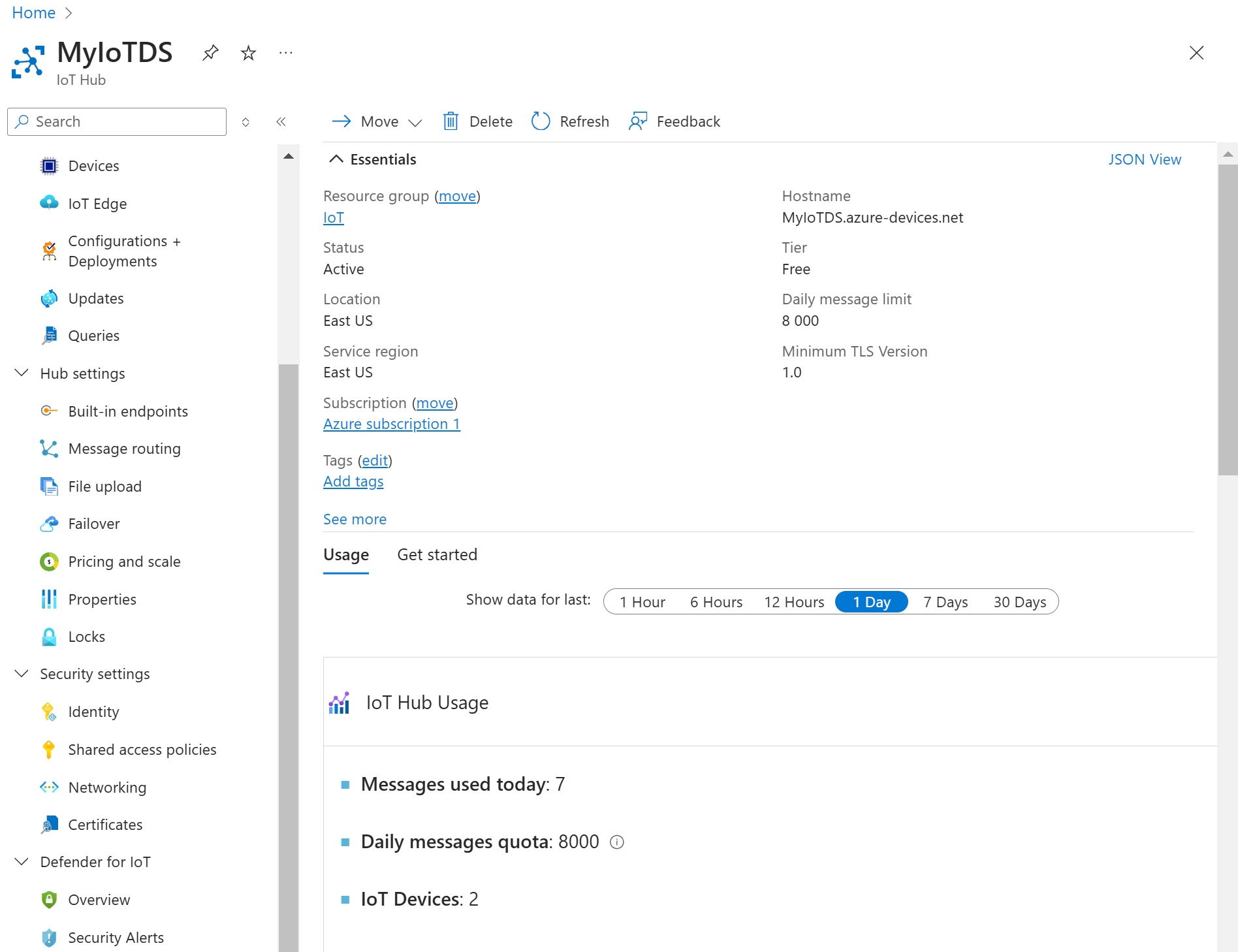

Here's a screenshot of my script and some info about the IoT hub I am trying to connect to. It says some messages are coming in but event monitor isn't showing any. And my device isn't logging "con" on connect as it should.

  broker = 'MyIoTDS.azure-devices.net'
  client:login_set("SpaceLynk","SECRET KEY")
client:connect(broker)
client:loop_forever()

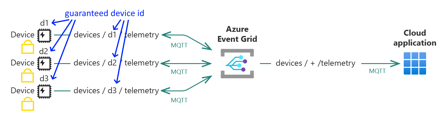

    If you want to send messages using the full MQTT protocol, check out the Event Grid namespace MQTT support.
    Security is enforced by certificates and you can event prevent spoofing using the various wildcards.
    If you want to test it, read this blog post about this MQTT broker with several examples.
