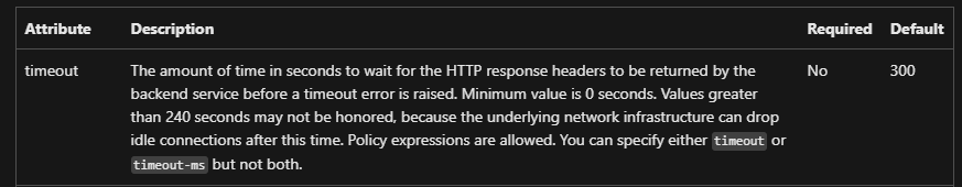

    This is a limitation in Azure infrastructure. Even though, you set timeout="1200" in the forward-request policy, Values greater than 240 seconds may not be honored, because the underlying network infrastructure can drop idle connections after this time. Please refer the documentation on forward-request policy where the below limitation is mentioned.

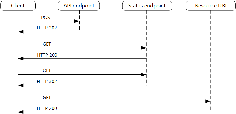

    You can make the backend service end point processing the file asynchronous and return a 202 response and implement some sort of polling mechanism on the backend service to get the status by hitting the end point in periodic intervals. Here is a typical flow to implement this
    Request and response flow for asynchronous HTTP requests
