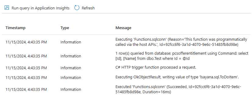

    Once all the configurations are in place, you should be able to hit the function app URL and get the results from the DB. Please refer the following invocation log and returned result from the Function app
