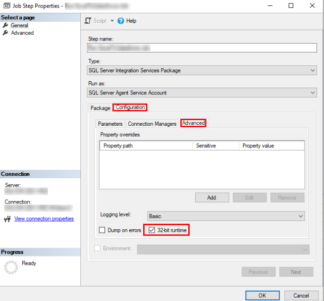

  1. ZoeHui-MSFT 41,491 Reputation points
    2024-11-18T06:09:35.8533333+00:00
    Hi @Naomi Nosonovsky,
    Edit the job step. Go to "Execution options". Try "Use 32 bit runtime" option.
    User's image Regards,
    Zoe Hui
