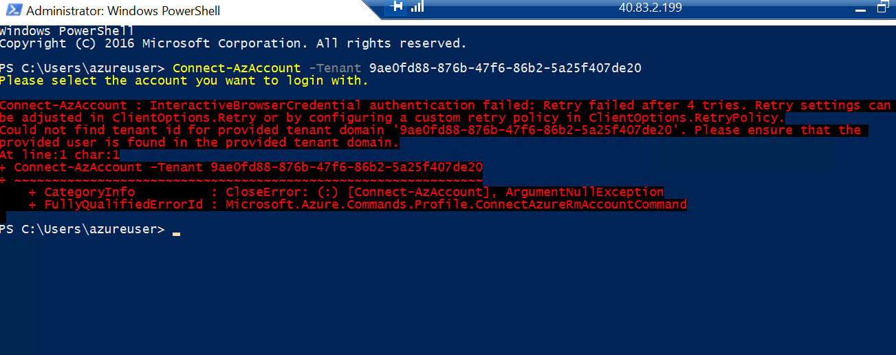

I have configured a secret in key vault so i'm trying to retrieve it in my vm by using powershell commands so i just need navigation steps to retrieve the secret and also i have added the access policies and selected the particular vm.

    4. Retrieve the Secret Using PowerShell:
      • Open PowerShell as an administrator on the VM and run the following commands:
             Install-module az
             Connect-AzAccount -Tenant <your_tenant_id>
             Get-AzKeyVaultSecret -VaultName "<your_vault_name>" -Name "<your_secret_name>" -AsPlainText
      • paint
      • NOTE: Replace <your_tenant_id> with your actual tenant ID, <your_vault_name> with the name of your Key Vault, and <your_secret_name> with the name of your secret.
    Hope this helps. Do let us know if you any further queries.
