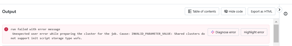

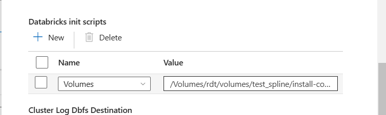

We have stored our init script in Azure databricks managed volumes path and we want to execute notebook via Job Shared cluster, the pipeline we are triggering is via ADF but the job cluster gives an error as
We are using Assigned Manged Identity as an authentication from adf to databricks and this identity has all the permissions on databricks resource and clusters, objects, also the adf service principal has all permissions.

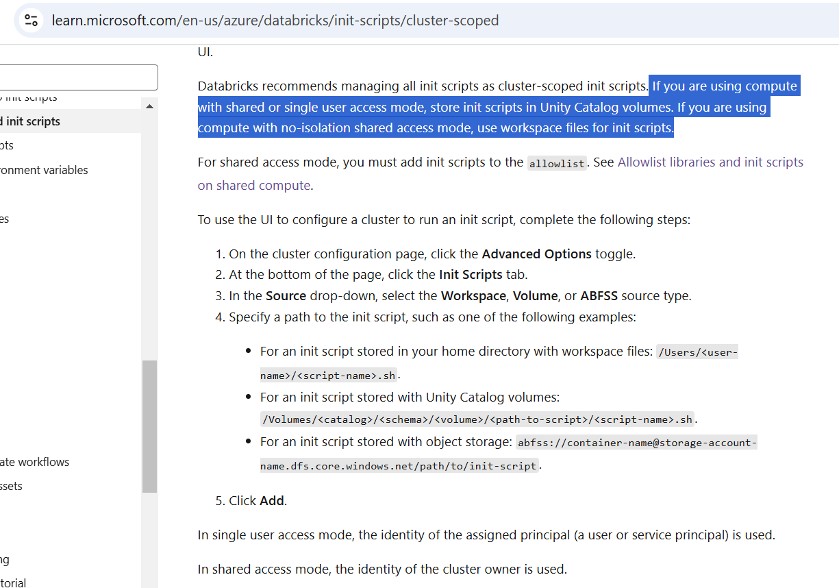

Please let us know why is this issue occuring and how to resolve it. Since as per Microsoft article Shared Compute cluster, volumes are supported.User's image

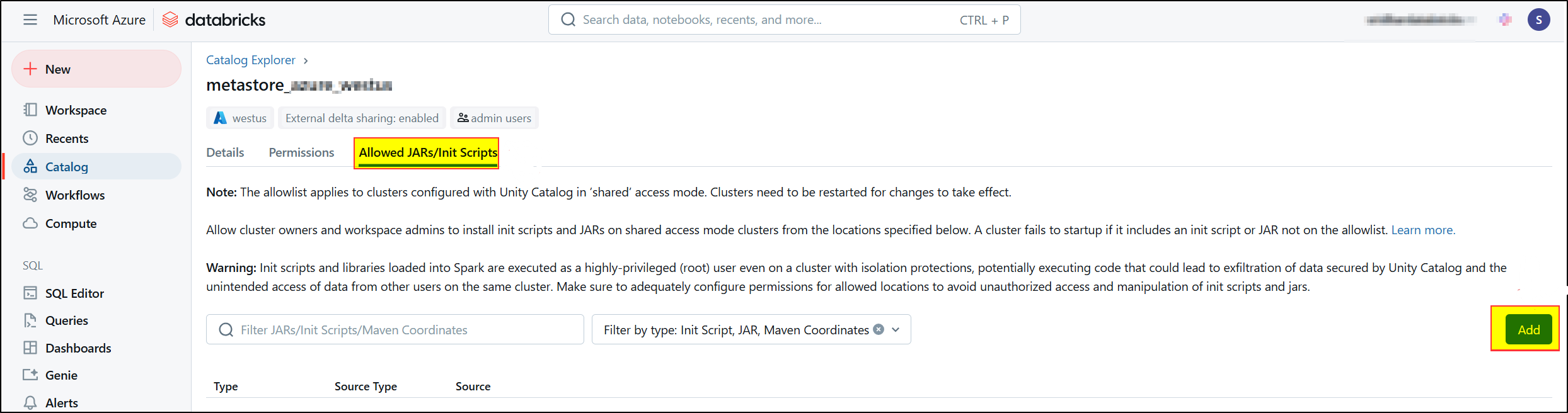

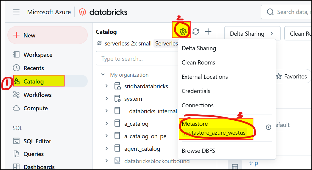

    2. Allowlist Configuration for Shared Access Mode: For clusters operating in shared access mode, it is essential to ensure that init scripts are added to the allowlist. Without this, the scripts may not execute correctly. For guidance on how to configure the allowlist for libraries and init scripts on shared compute clusters, you can refer to this documentation.
    You can do something like below:
