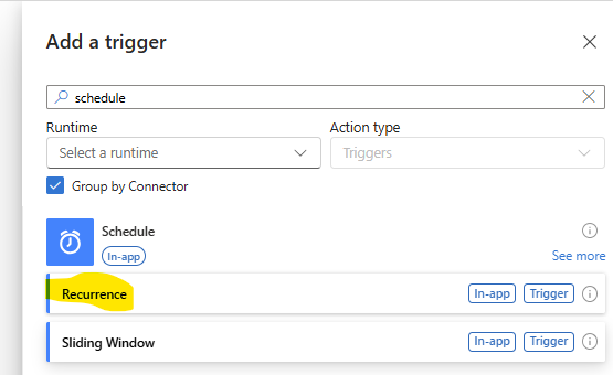

I need to use the "Recurrence" trigger in Logic App, where it will perform some job in particular time time interval, e.g. every 5 minutes.
I managed the get this "Recurrence" trigger from the consumption plan.
However it seems not available with the standard single tenant plan, at least I can't found that from the list.
Please advise.

    You must be trying to use the Recurrence trigger from Standard Logic App stateless workflow. Please note that the trigger is currently unavailable for Standard logic app stateless workflows. Please refer the following limitation outlined in the Recurrence trigger documentation.
    As you create a workflow in the Logic app, please make sure you select Stateful as the state type and you can access the trigger from the designer.
