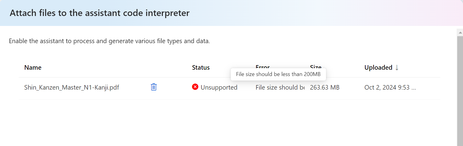

About this case, I posted in azure github, but do not get answer yet.
https://github.com/Azure/azure-sdk-for-js/issues/31148#issuecomment-2389261458
Describe the bug When attempting to upload a large file (>200MB) to the Azure OpenAI API using the OpenAI Node.js SDK, the request fails with an ECONNRESET error. The error seems to occur when the upload exceeds a certain size, as smaller files upload without issue. https://platform.openai.com/docs/api-reference/files/create
 const file = await openai_client.files.create({
      file: fs.createReadStream(path.join(__dirname, './uploads/testfile.pdf')),
      purpose: 'assistants',
Expected behavior The file should upload successfully without a connection reset error because there is a description in api documentation like - Individual files can be up to 512 MB, and the size of all files uploaded by one organization can be up to 100 GB.
Additional context Additional Info:
The issue only occurs with larger files (200MB+). Smaller files upload successfully. Node.js version: 20 OpenAI SDK version: V2
