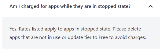

    Stopping a web app does not save cost. You are still charged for the instances in the App Service Plan, even if all web apps in the plan are stopped. Please see below from pricing FAQ:
    One potential method to save money is to switch to Free/lower cost SKU when not using web apps, and then switch back to Premium when you want to use them again. If running multiple instances (as in your case), you could reduce (but not eliminate) some costs by scaling in from 2 instances to 1.
