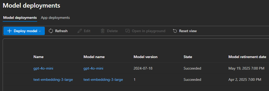

  2. Added two deployments
    1. gpt-4o-mini
    2. text-embedding-3-large

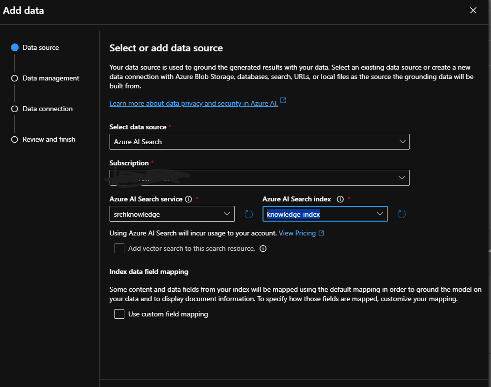

    2. Tried To Add Data Source With Vector Search Enabled
      1. clicked "Add a data Source"
      2. Selected "Azure AI Search" for my data source
      3. Selected my subscription
      4. Selected my Azure AI Search Service
      5. Selected my Azure AI Search Index
      6. At this point I would like to check the "Add vector search ..." checkbox but it is disabled
Screenshot 2024-11-21 003312
The checkbox "Add vector search..." is disabled.
Screenshot 2024-11-21 002753
Here is the index's json if that helps:

  1. romungi-MSFT 49,086 Reputation points Microsoft Employee Moderator
    2024-11-22T11:41:34+00:00
    @Jeremy Vetter I have tried to add your JSON as an index to my search resource and while adding I removed the semantic section of the JSON and used it in my BYOD configuration of OpenAI model. See the screenshots below:
    Vector Profiles:
    No Semantic Config:
    Now, using the same index in the BYOD screen, it enables the option to enable vector search.
    In the Next screen you have the option enable Hybrid search (Vector + Semantic) choose this option and continue rest of the setup.
    Where Hybrid ( vector + keyword) is:
    See this page for details.
    For your other question, If you enable vector search Azure OpenAI uses the selected embedding setting to vectorize the chunks. This is documented on this page. I hope this helps!!

    This option is not available for the embedding deployment with model "text-embedding-3-large". As soon as you deploy the model "text-embedding-ada-002" in your OpenAI Service instance, the option to use Vector Search with your Azure AI Search Data Source is enabled.
    This is a major drawback, as now the vector dimensions need to match and your Search Index embedding must also use the "text-embedding-ada-002" OpenAI model as vectorizer.
  3. fabs 0 Reputation points
    2025-08-21T22:10:14.3266667+00:00
    Jeeezzz, I was about to despair about this. Nothing of the above seemed to help. For my case, ultimately, the solution was enabling CORS. See this page: https://learn.microsoft.com/en-us/azure/ai-foundry/openai/concepts/use-your-data?tabs=ai-search%2Ccopilot#regional-availability-and-model-support
    After having created the indexer, index and data source using the "Import and vectorize data" wizard, I had to navigate to the index's own settings and simply enable CORS. See screenshot:
    Screenshot 2025-08-22 at 00.08.35
