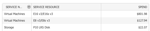

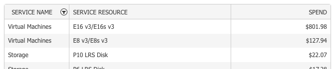

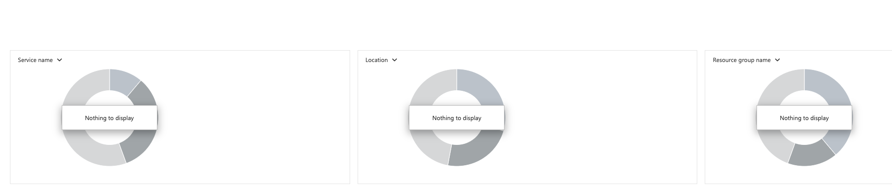

i'm running a VM through the AI studio and the ML studio.
the general cost is about 0.2$ per hour. for some reason it got to almost 800$ in just few days (i see it from the usage details) but i don't understand why.

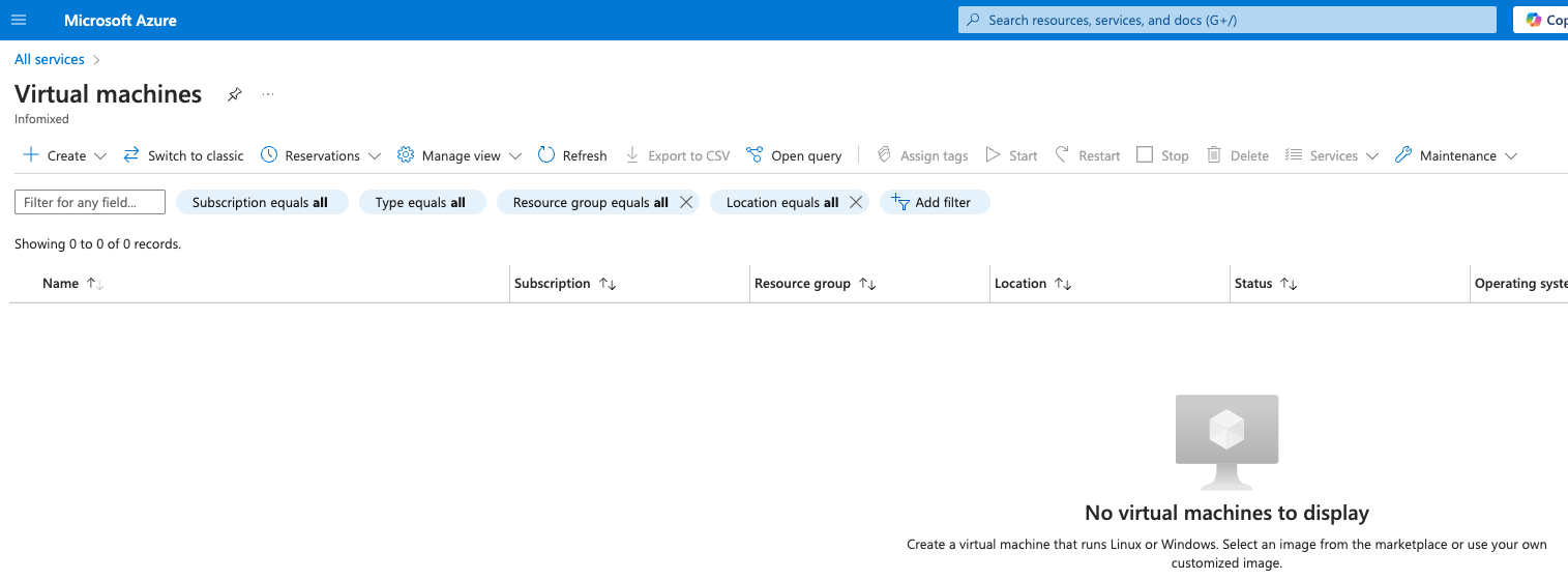

    From your description and screenshots it appears you have compute cluster/similar resources in ML/AI Studio that are using E16v3 and E8v3 virtual machine instances. Depending on how you configured things you could potentially have many instances running at the same time, accruing costs rapidly.

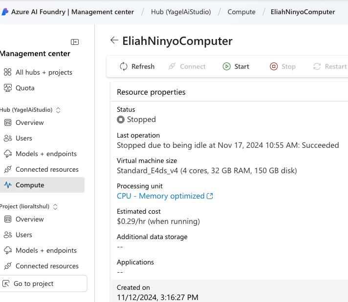

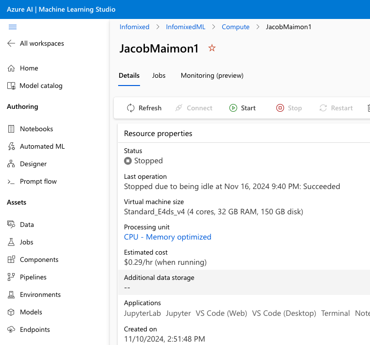

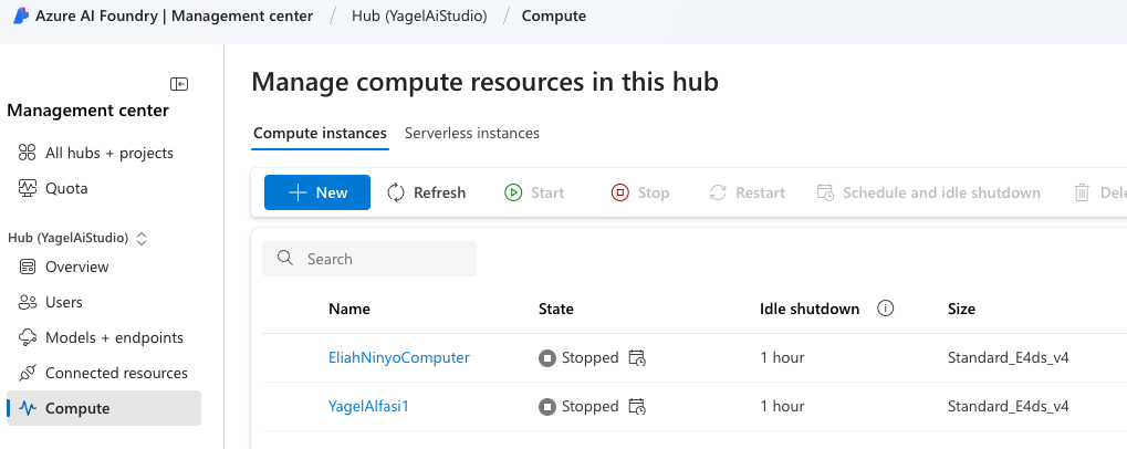

    You can look in AI Studio and ML Studio to see what compute resources you have created. For example, navigate to ML Studio, on left click Compute, and then on right check Compute instances, Compute clusters, Kubernetes clusters, etc. In AI Studio, on left click on Management Center, next on left click on Compute, and then check Compute instances tab on right.
