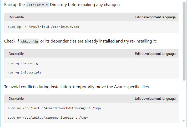

    Backup and Remove Existing Files: Before making any changes, it's a good idea to back up the existing files.User's image
    P.S.- I have an editor issue here with commands above, hence adding a screenshot of the commands instead.
    If the issue persists, you might need to check if there are any specific dependencies or conflicts related to the chkconfig package and the existing files.
