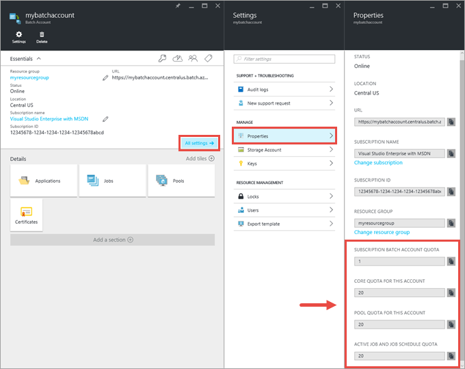

    You can check your azure batch account->settings->properties and see what's the default quota assigned for the particular account.
    If the "Pool quota for this account shows me a quota of 20 pools for this batch account, and you haven't exhausted it, it could be that the default value internally for the quota might be set to 0

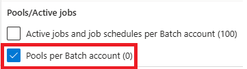

    Please navigate to your Batch account in the Azure portal and check the Settings -- Quotas blade. You may not have enough quota to create a new Pool.

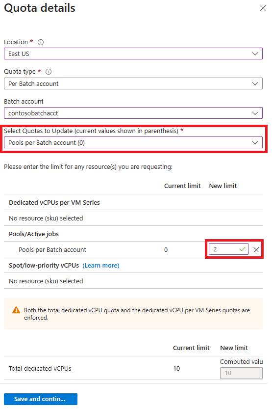

    You may click Request quota increase. For Quota type, select Batch, click Next.
    On the Additional details tab, under Provide details for the request, click Enter details. Select region, per batch account, your batch account.
    Under Select Quotas to Update (current values in parenthesis), scroll down all the way to the bottom and select Pools per Batch account. Additionally, select VM family that you need if appropriate.
    Once you have selected Pools per Batch account, click the arrow to collapse the dropdown and then enter the number of pools you are requesting in the box. Click Save and continue.
    Fill out the remaining information for your support request, contact info, etc, click Next, click Create. You should receive a confirmation email within a few minutes and then you will be contacted regarding decision on your request.
