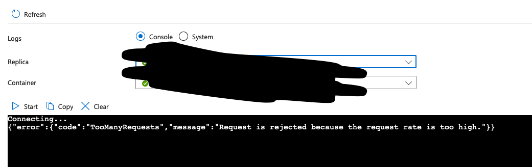

We're using container apps for our service.
When we do load testing, we sometimes see:
{"error":{"code":"TooManyRequests","message":"Request is rejected because the request rate is too high."}}
in the Console logs.
I can't see any mention of a 'request' quota in the container apps documentation.
I think this error code is actually related to scaling the replicas? But even this should be within the limits. I have a max replicas of 12 and we're using the 8 core dedicated machines which should stay within the 100 core limit (8*12 = 96).
I can also do a load test of 'hey -n 100000' (https://github.com/rakyll/hey) and the server can respond with 100k 200 status codes. So I don't think it's the raw number of requests.
Our typical requests are very CPU intensive. Even 10 simultaneous requests after a few minutes can run into this rate limit.
Any help or ideas appreciated!

    Hi Michael,
    From your description it seems you are refreshing the logstream too often and you are being throttled as a result. When you use the portal and view the console logstream, the Azure portal makes requests to the API. The various Azure APIs have request limits, some of which are published while others are not.
    Is there another way you can achieve your goal instead of relying on the console log in the portal? For example, can you send key status messages to another endpoint which logs to files, and then view the files?
    Or, another potential is to view the log stream not via the portal but using a different method. For example, you would write small script that makes the requests to view the log in a more controlled manner (and maybe using different parameters) so as to not trigger throttling.
