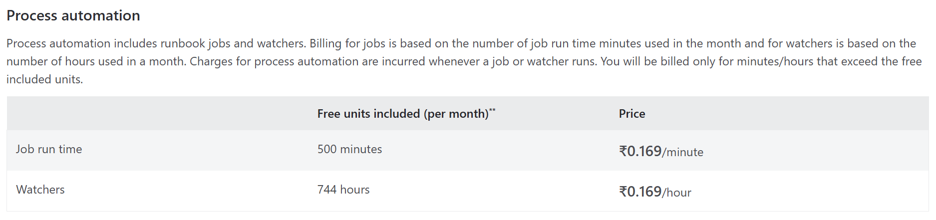

    Below is the costing for Azure automation :
    Can you definitely confirm that throughout your month, your overall time across all automations didnt exceed 500 mins?

    Am i being charged for schedules? There are no charges for schedules themselves. Charges are incurred based on the job run time minutes used by the runbooks.
    am i being charged for some logs? You are only charged for the log data stored in the Azure Log Analytics service. There are no additional charges for the service itself
    am i being charged for something or anything else when using the runbook to only scale up or scale down? Charges for process automation are based on the number of job run time minutes used in the month. The first 500 minutes are free, and beyond that, the cost is $0.002 per minute.
